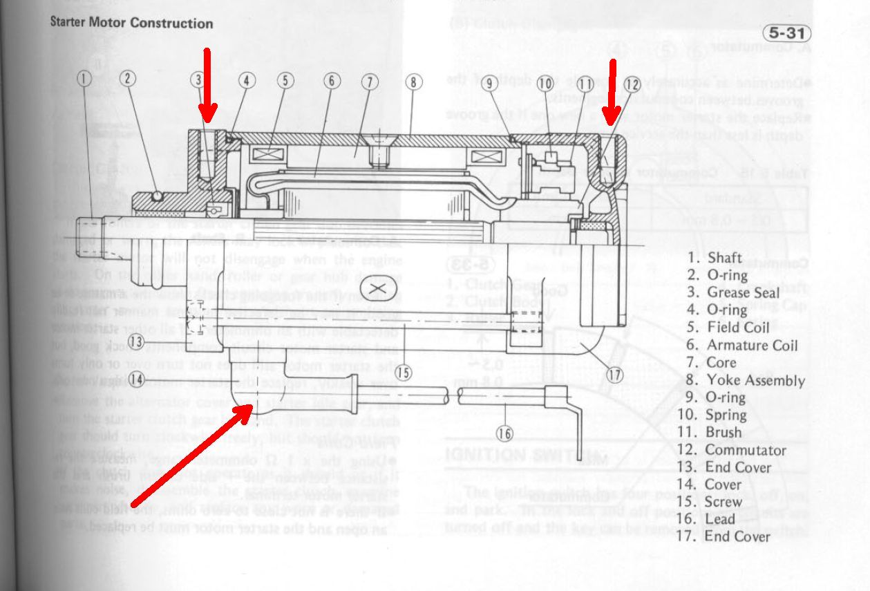

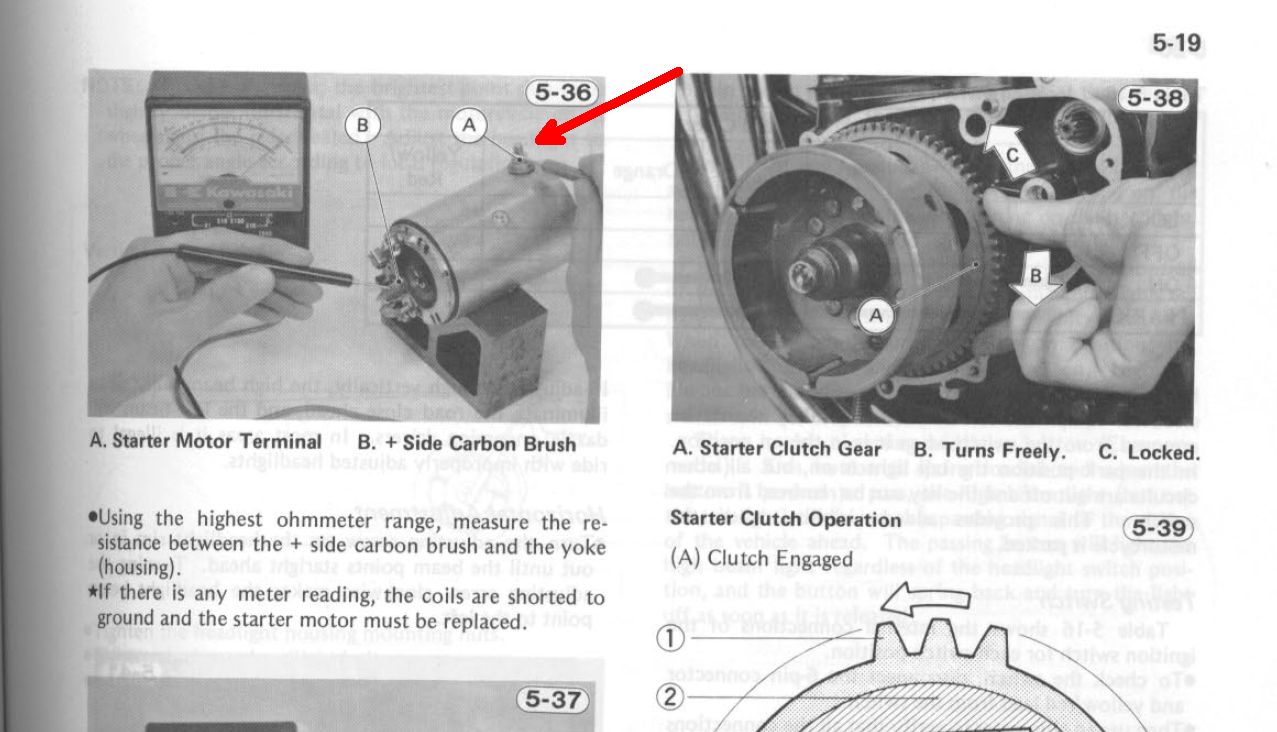

This is the positive terminal bolt.
The starter housing is the negative terminal.

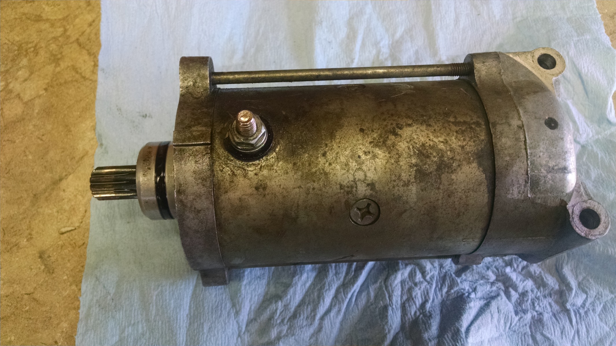

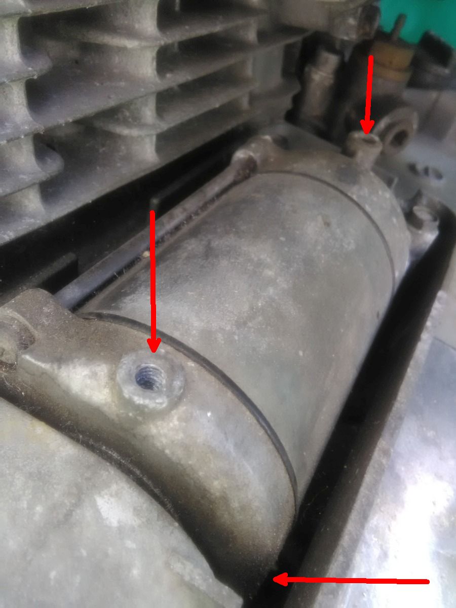

Thanks for the speedy reply.I'm still not sure which it is, but here's what I'm looking at.the picture may a bit fuzzy, but there is no stud on the back bolt holes either

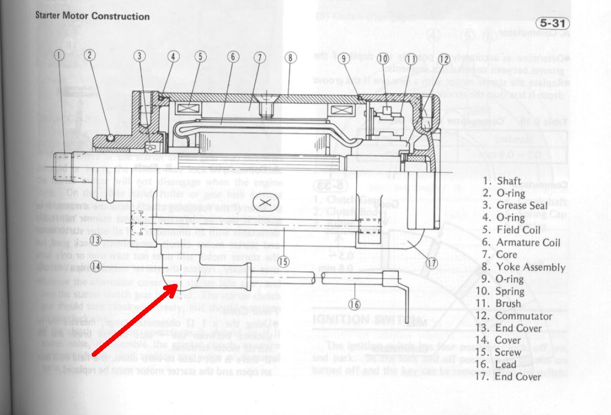

The positive stud is on the bottom, you have to remove the starter motor.

It's behind the sprocket cover along with the stator connections. You must remove the sprocket cover first to remove the starter since the cable connects to the bottom.

Noffke wrote: Thanks for the speedy reply.I'm still not sure which it is, but here's what I'm looking at.the picture may a bit fuzzy, but there is no stud on the back bolt holes either
The threaded holes on top are just for the two cover bolts.
