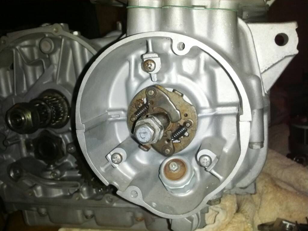

Can someone school me on this?
Basically what wire goes where
Crazy theres 7 damn wires coming out of the box lol
Cdi box
7 wires
3 black
2 red
1 white
1 green
Cdi "plate"
4 wire
1 green
1 white
1 red
1 black
Also the plate has a "loose" green wire at the plate end of the wiring
Little confused on what that goes too
Thanks in advance fellas!
Cdi box
7 wires
3 black
2 red
1 white
1 green
Cdi "plate"
4 wire
1 green
1 white
1 red
1 black

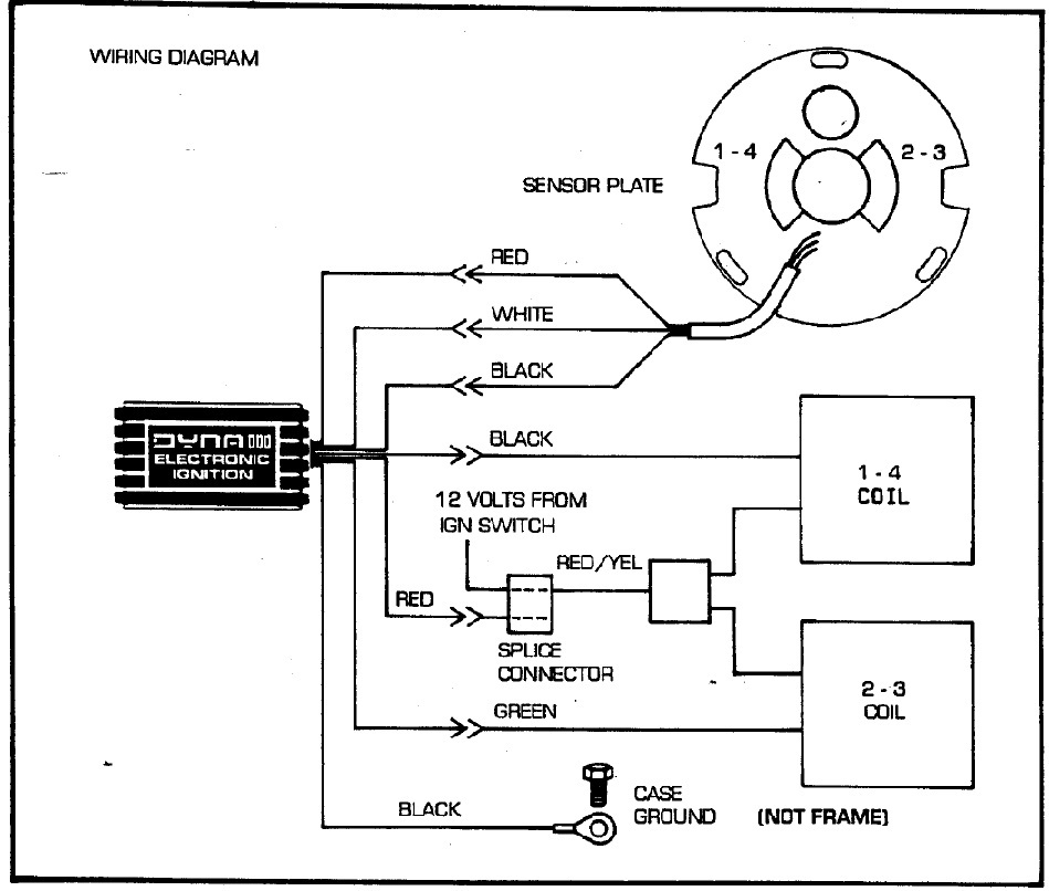

The green wire is for the oil pressure Switch behind the pick-up plate.

It's surprising that the 1-4 coil wire on the igniter is black. The other two black wires are ground, so those might be interchangeable, but if you swap one of those ground wires with the black coil wire it definitely won't work. And the coil and battery might get sad in the process.
