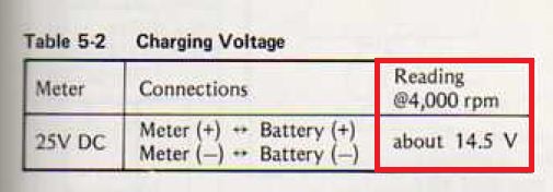

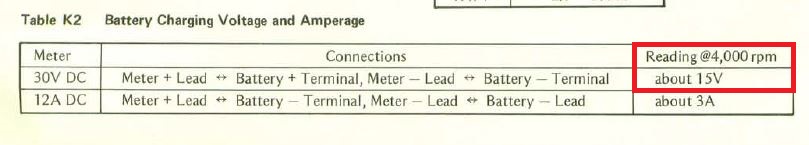

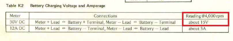

Still wrong. Please take a look at the Kawasaki Service Manual. Below are examples from the 1977 KZ650 Kawasaki Service Manual and the 1981 KZ650 Kawasaki Service Manual. Those two models used different charging systems, so the specs are slightly different, but please notice that in both cases the correct voltage is higher than what you specified. I am quite confident that the folks at Kawasaki who engineered these machines had a thorough understanding of charging systems and batteries. Ed
