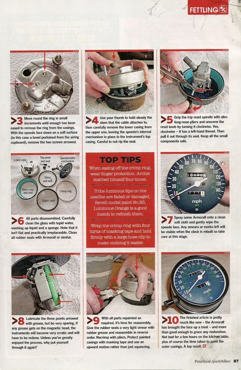

Thanks. The knob does unscrew backwards in the opposite direction as resetting the trip meter:
The speedometer has to be separated first >> then use pliers to hold the shaft while unscrewing the knob.

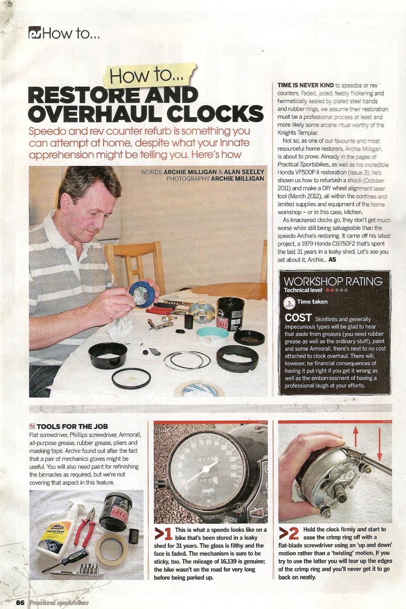

Re: How to remove speedometer reset knob?
14 Mar 2019 13:31

Thanks. I've been looking for that how-to. hee. I thought I had a link to it saved in a word file, but I couldn't find it. Now I realize I had those pics saved on imgur. doh. could have saved myself some trouble. :laugh:
1981 KZ650-CSR. Trip reset knob removal. see text in pic.
