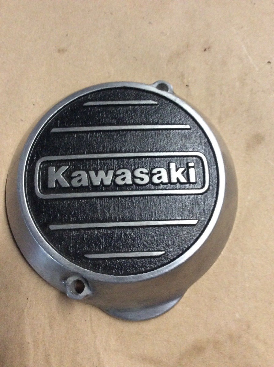

However, Ive noticed a lot of KZ have this nice looking cover below which has a part number of 11012-1098
Will the latter fit on a 77 B1 KZ650?

Pretty much all of the ignition covers for Kz400-4, 500, 550, 650, 700, 750-4 will bolt onto any of those motors. The only difference I notice is that the ones designed to be used on electronic ignitions have a tiny bit more headroom to clear the advancer bolt. So later ones should easily bolt onto earlier points-motors without issue.

I have the dyna S on my KZ650 with the stock cover but it wont polish up like i want. I like the finned black one, but its on ebay for $200 and thats way too much.

I would try polishing the stock engine covers using a polishing wheel & various compounds, maybe various clay bars. As for swapping covers, were you also planning to swap out the generator cover? Depending upon what generator/stator you have, it may not be that simple on a 77 650B. It would be weird to have mismatched engine covers. And just an FYI. If a motorcycle has the same engine cover gasket, then there's a good chance the cover will swap. For example the 90s 550/750 Zephyrs & later ZR7/ZR7S models use the same pulsing coil cover gasket, so one of those covers might fit as well.

The bike will end up looking like it survived a bad wreck. Upper case letters on the tank, upper/lower case letters on the points cover, black stripes on one cover, etc. Just polish the cover properly or pay someone to do it and it will look fine. Ed

Thanks Ed. I did decide even before reading this, to save money and just polish!

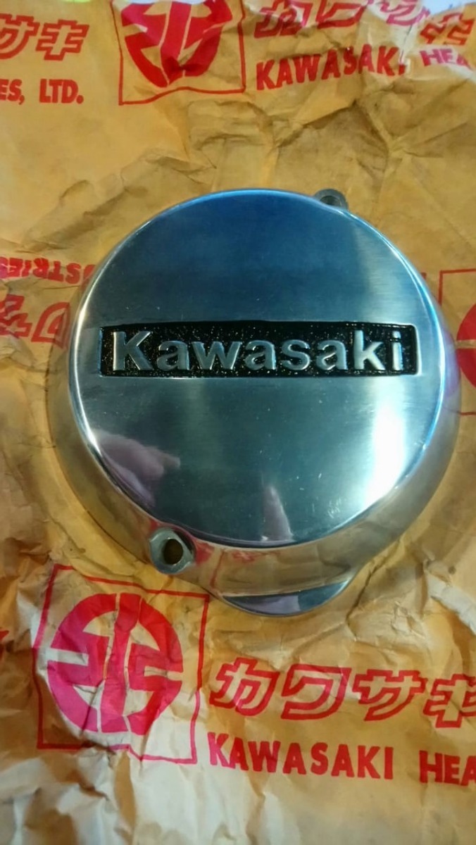

Some stock covers from over the years, all able to fit a 650:
Stock '77 & '78 styles, with aftermarket lexan cover:
Aftermarket DOHC points cover from a ZR7, from Webike Japan:
