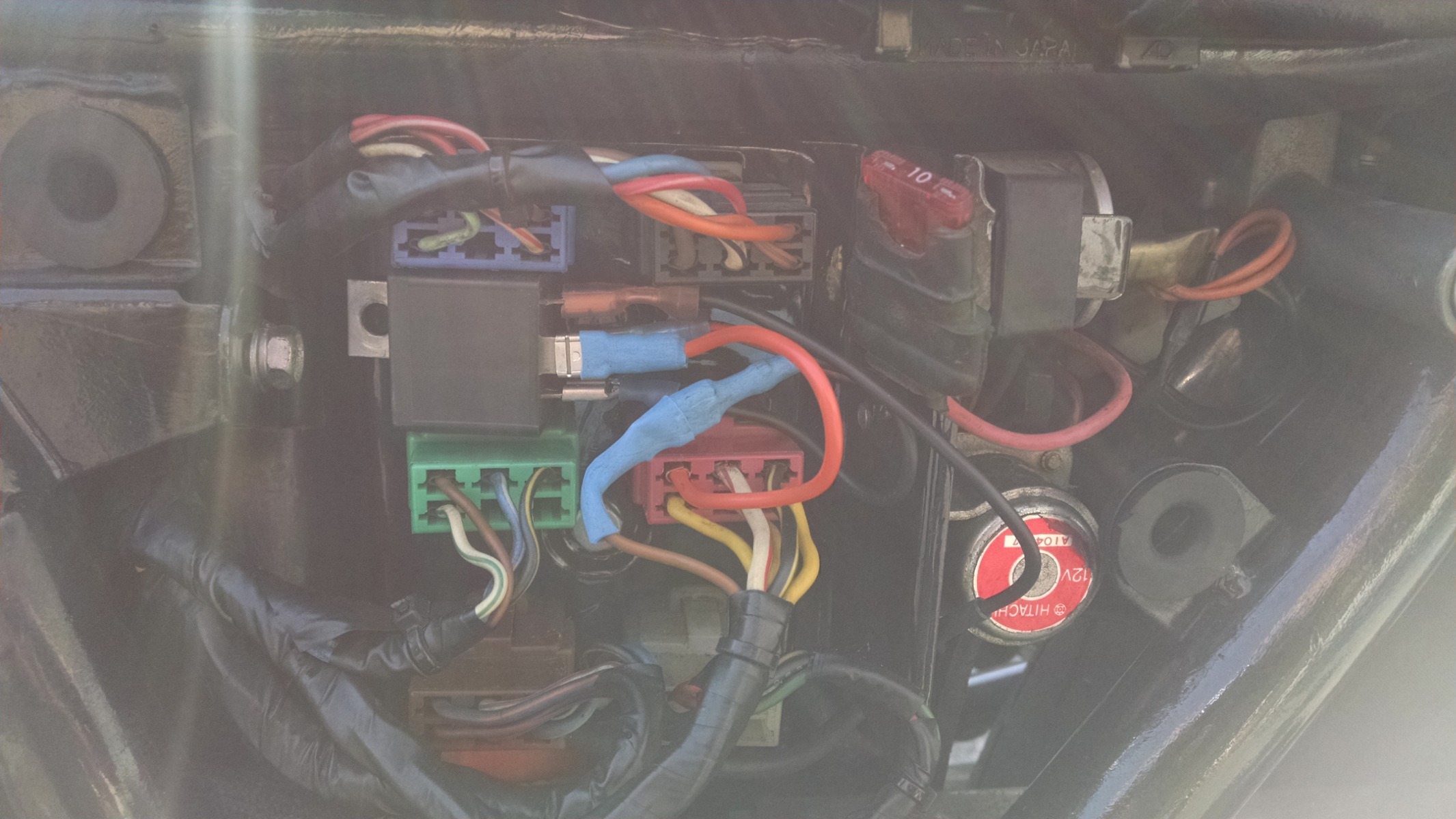

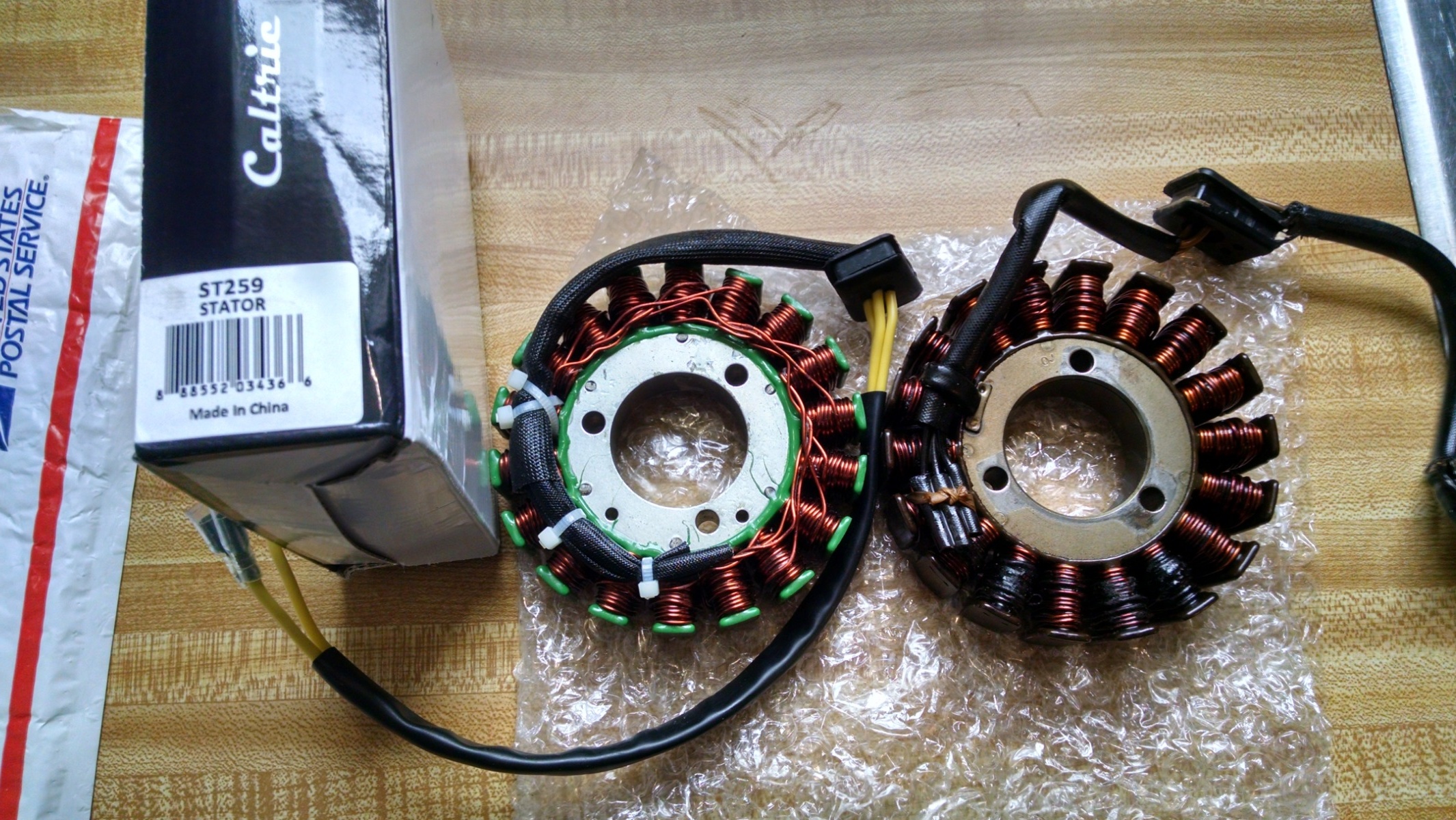

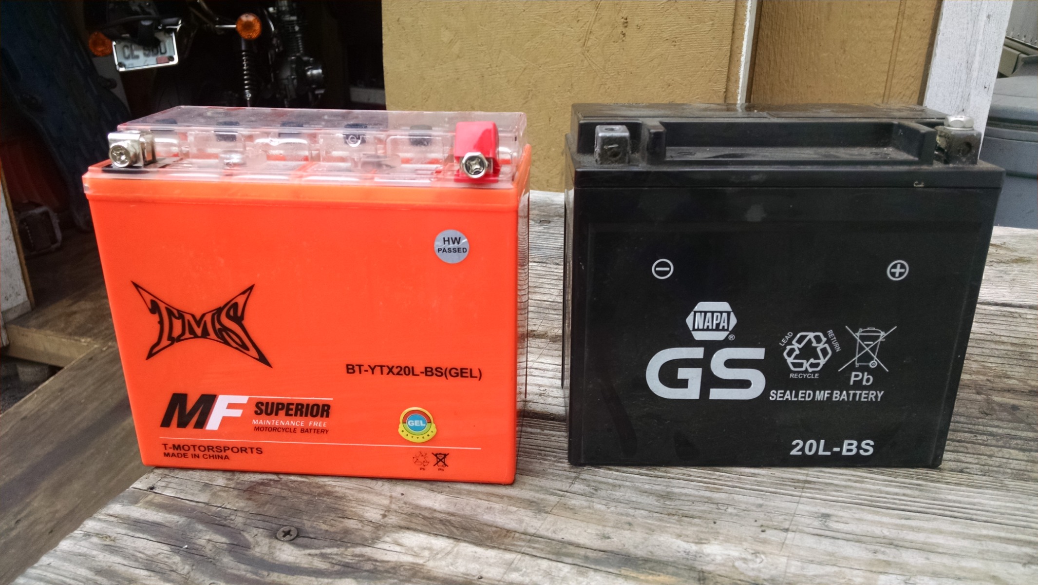

Now back to reality, I bought a cheap AGM battery off of ebay in oct 2016, then in the fall of 2017, it started to act like it wasn't holding a charge and starting slowly, when in actuality the bike was not charging properly due to a shorted stator and a voltage drop to my voltage regulator on the sense (brown wire).
I replaced the stator.
Added a relay to provide full battery voltage to the brown wire.
and the same AGM cheapie is still going strong. Gel cell cheapie.
