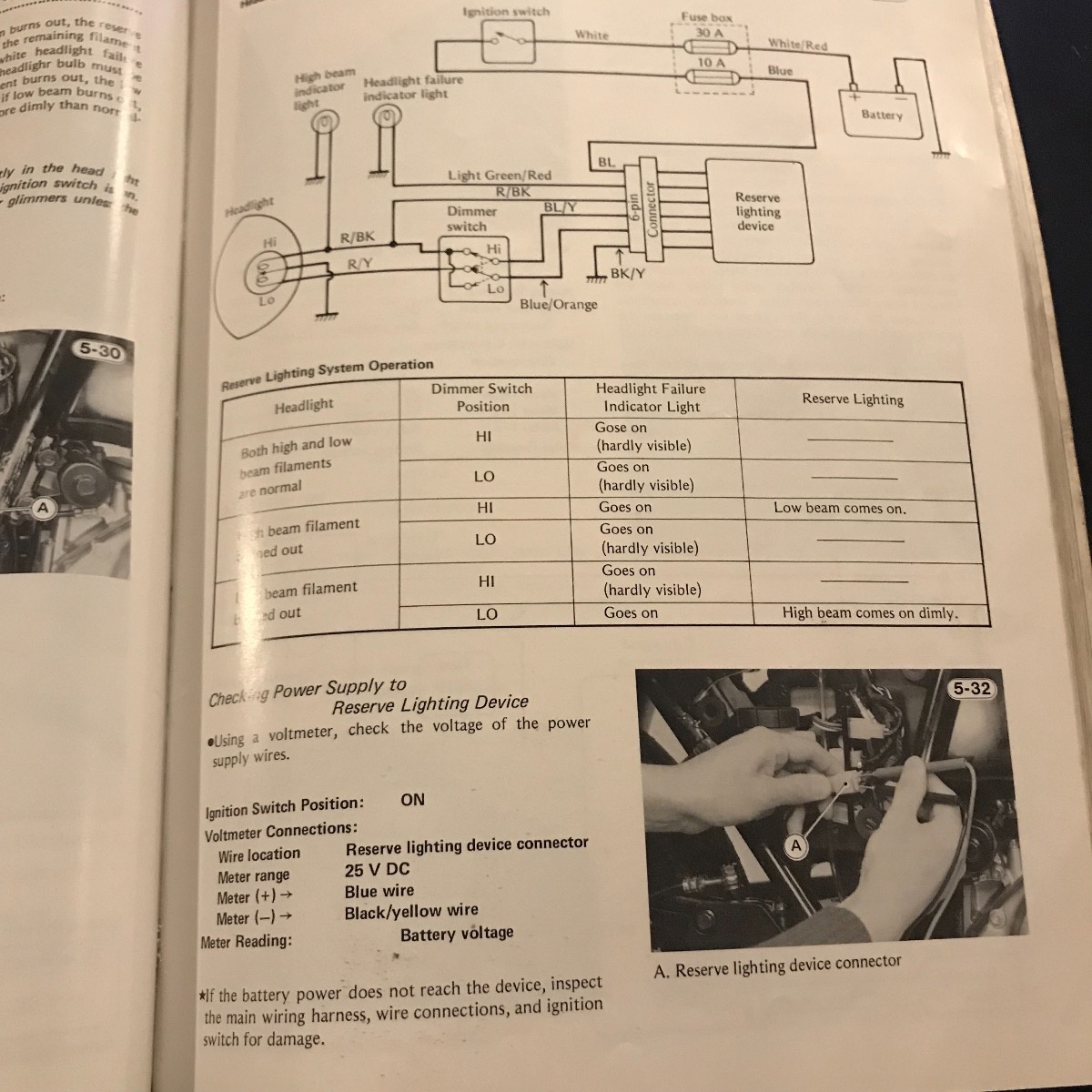

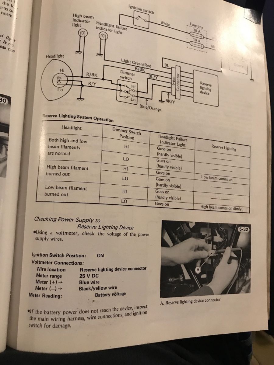

Don’t know if this will help at all. Could this be something with the reserve lighting device?
So, currently. The way I have it set up I can start the bike in IGN and on ACC. But the headlight stays on on ACC. And the bike still shuts down when high beams are on and won’t start on high.
Thanks.
Thanks.
