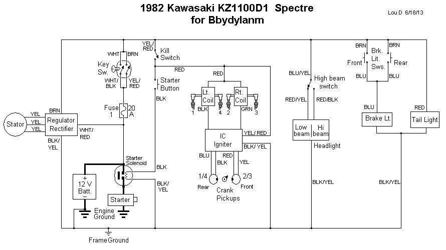

Hey guys, I am following the wiring diagrams that have been posted on this site and I must say they are awesome. However, I have one question. I have 5 wires coming from the stator in a loom---they are 3 yellow wires and then a blue red and a green red I believe (sorry, at work and going off of memory here). Anyway--the blue red and green red, where do they go? I don't see them on the diagram.

ok, so in the diagram he has laid out---where do they go then? Also, pretty sure that I hooked up the neutral indicator to the engine case--so the other ones goes to the speedometer neutral light indicator you mean?

Have you hacked your wireing? It should go to the same plug as the yellow and blue wires.

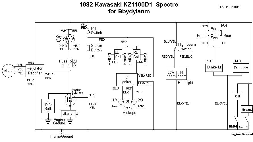

In the above diagram requested by a member, he eliminated the gauges so he had no use for the oil pressure wire and the neutral switch wire.
The oil pressure light wire and neutral light wire are ground sides for the bulbs. The oil pressure wire goes to a switch somewhere on the oil pan or crankcase, and the neutral wire goes to a switch elsewhere on the crankcase or transmission cover.
