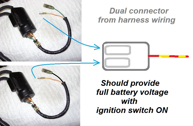

jadkins91 wrote: . . . getting 12 volts at my coils until i plug them in. After i plug them in the voltage drops to about 8v. What could be causing this?
plug them in -- what does this mean?
getting 12 volts at my coils until i plug them in -- 12 volts measured where?
After i plug them in the voltage drops to about 8v -- 8v measured where?
It's the red or red/yellow wire from the harness that typically splits and feeds battery positive voltage to a primary terminal on each of the two ignition coils.
Measure the voltage at the plug from the harness before connecting it to the coil.
Ideally, the voltage (at the plug from the harness before connecting it to the coils) should match the voltage as measured at the positive battery post (terminal).
The following illustration for larger fours might be helpful.

Thanks for the response. Here is a brief rundown of the past week.
- Low voltage at coils so i installed the wired george mod which I assume I had wired it wrong due to the points burning up.
- Bought new points and installed them . Adjusted gap and timing using the continuity method.
- Turned the key on and one of the main fuses blew.
- Noticed that 2 wires leading into the kill switch assembly were nicked and to be safe i installed the assembly from my 81kz750, bypassing the headlight switch.
-Turned the bike back on and all was good. Had ~12V at the yellow/red wire that feeds the coils until i connected the coils then the voltage dropped to around 7-8v.
- I then turned the bike off and back on and the same fuse blew.
I though I had it all figured out..really frustrating.

jadkins91 wrote: . . . Had ~12V at the yellow/red wire that feeds the coils until i connected the coils then the voltage dropped to around 7-8v. . . .
7-8v measured where?

jadkins91 wrote: At the yellow/red wire that feeds the coils.
What type of volt meter is being used on an already connected wire?

I'm using a Fluke 323 Multi meter that i used when i was an electrician. I placed the black lead on the negative terminal and inserted the red lead up in the connector.
