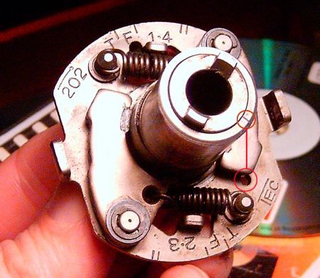

On electronic ignitions, the pointer of the rotor should point toward the side of the advancer that has the "TEC" logo stamped in.
On points ignitions, the cam lobe has a tiny notch stamped into the top of the tube. THat notch should point toward the side with the "TEC" logo.
www.kzrider.com/media/kunena/attachments...entationadvancer.jpg
