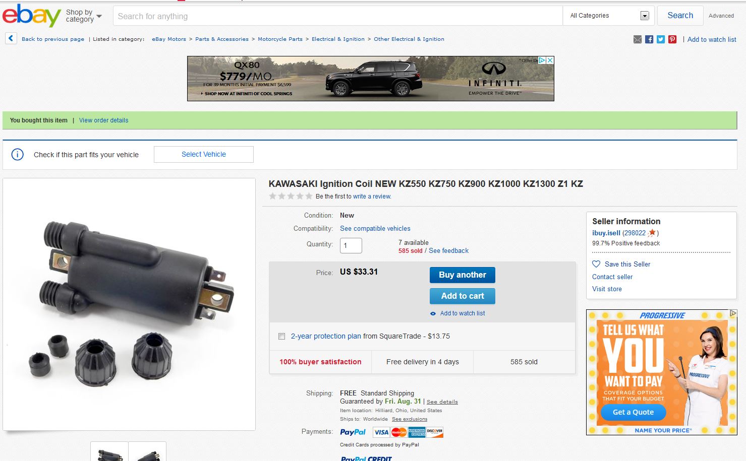

Your coil primary measurement is right on at 2.4 ohms. If it is an original 40 yr old coil, you will probably want a new one regardless. One that old can get you stranded especially if you get caught in a really bad rain. The coils develop micro-cracks over time and will work until they get wet, then you can get stuck.
Fortunately, there are some no-name coils on ebay that exactly match the original factory coils and they are pretty inexpensive. I've been using a pair of them for a few years and have had no problem with them.
You should get new wires too. Get the coil first so you will know what size wires to get.
If money is no object, then you would want a full-size, gray, 2.2 ohm coil from Dyna. That matches your coil electrically, but might require slight mods to mount them.
MEasure the mounting posts of your old coil so you can compare with new coils.
