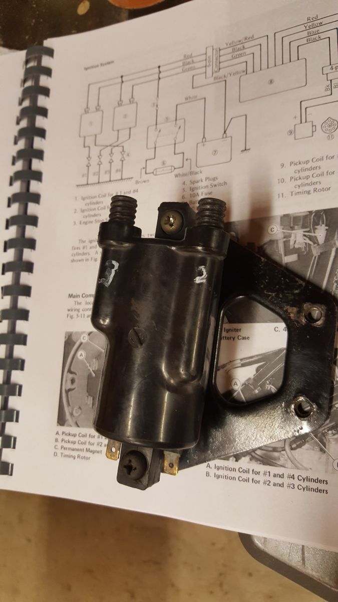

Fixed the starter yesterday.
One Coil died on the way home from work today.
Didn't even go 24 hours between breakdowns.
Switched them out to confirm it was dead.
Bought a used one on ebay for $24.
Down again.
Down again.
1982 KZ1100 D-1
- loudhvx
- Posts: 10863
- Thanks: 1622
Re: Coil 82 KZ1100
24 Aug 2018 06:42
Coils get micro-cracks with age and heat. Eventually moisture gets in. An old, used coil will fail sooner rather than later. It seems you can get about a solid 20 years out of them. After that, it's borrowed time.
