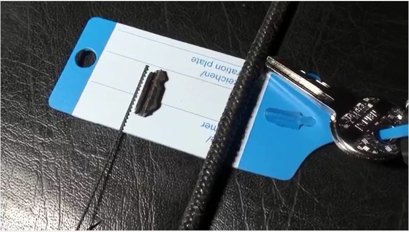

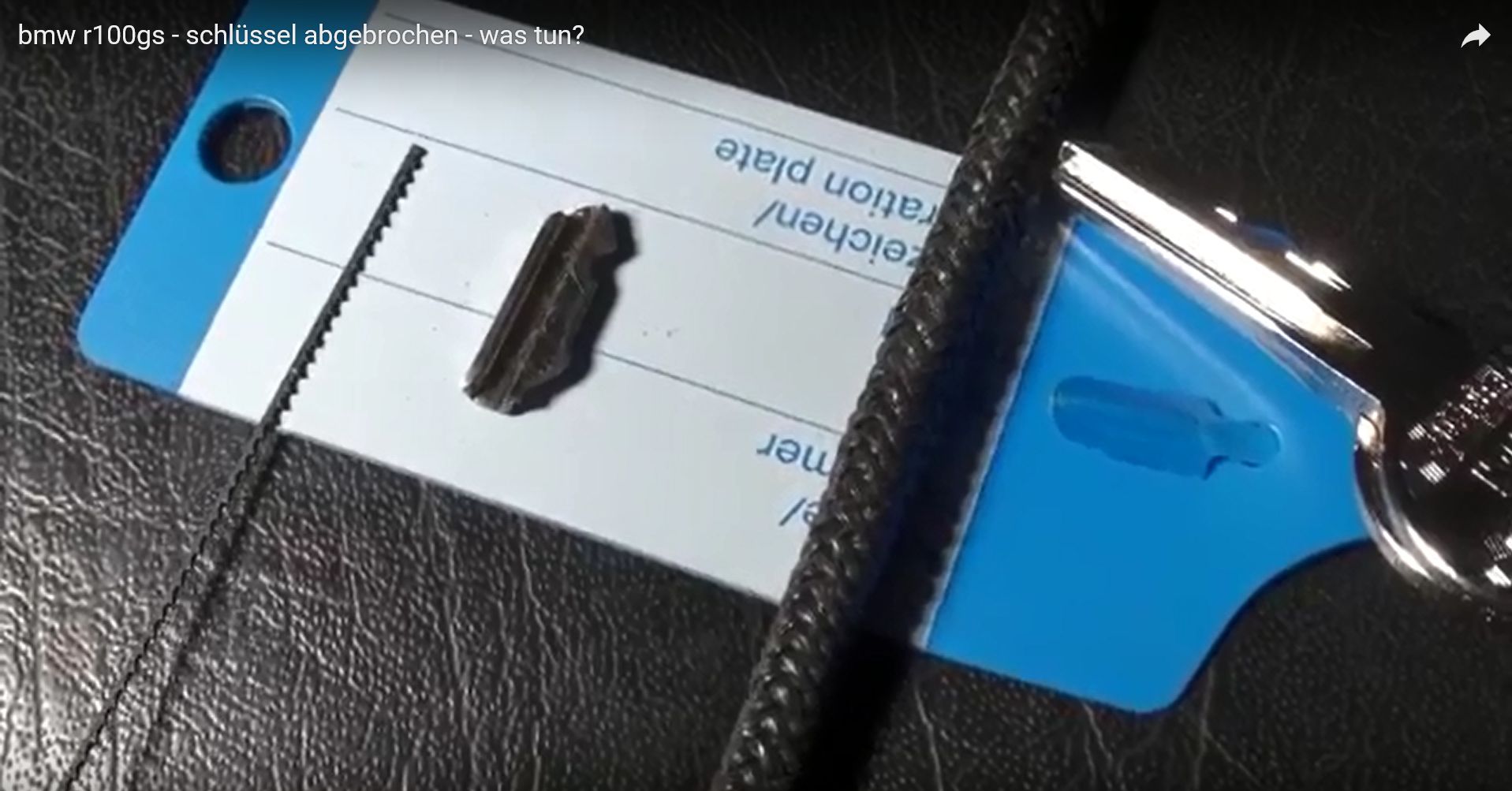

Re: Stuck key
11 Aug 2018 03:46 - 11 Aug 2018 03:53
Last edit: 11 Aug 2018 03:53 by Scirocco.
- Posts: 7993
- Thanks: 1648
Re: Stuck key
11 Aug 2018 05:23 - 11 Aug 2018 05:23
Great pics. That's a nifty tool. Is that a locksmith specific tool?

Re: Stuck key
A locksmith do the same job for 50 bucks. :laugh: :laugh: :laugh:
