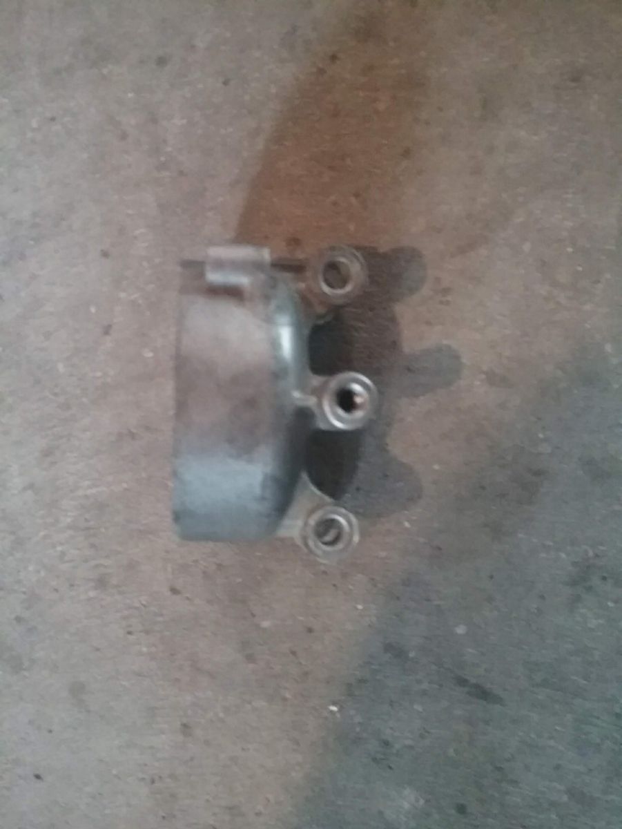

10 Aug 2018 06:25That is what I am worried about.TexasKZ: There seems to be no mica at all between the segments. Won't that be a problem ? It appears to be a lot more than the 0.2mm maximum allowed by Kawasaki.

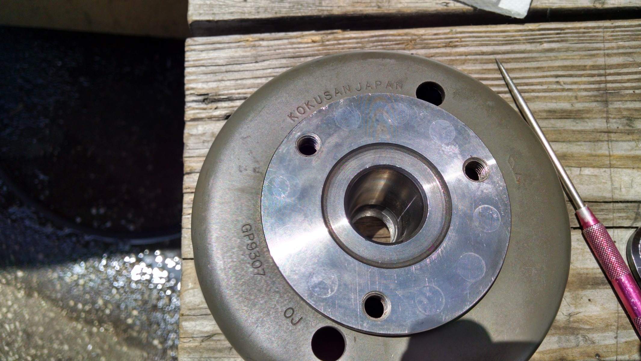

I ended up just buying a used starter from cyclesrus.com, put it in and it turned over. Wouldn't start though, sprayed some ether and got it to start. Once it was warm it would turn off and restart, but I think I need a new starter clutch. I keep getting a clunk/grinding noise every once in awhile.

19 Aug 2018 20:57 - 19 Aug 2018 20:58M_a_t_t wrote: I ended up just buying a used starter from cyclesrus.com, put it in and it turned over. Wouldn't start though, sprayed some ether and got it to start. Once it was warm it would turn off and restart, but I think I need a new starter clutch. I keep getting a clunk/grinding noise every once in awhile.
The starter clutch in the back of the alternator rotor comes loose and rattles. Mine didn't completely fall apart, but I could hear a noticeable rattle on the left side of the engine. Now might me a dandy time to go ahead and pull the rotor and either clean and loc-tite the bolts on the clutch before it also fails or replace whatever might be worn or missing / broken Matt.
It attaches to the 3 holes on the back of the rotor.
