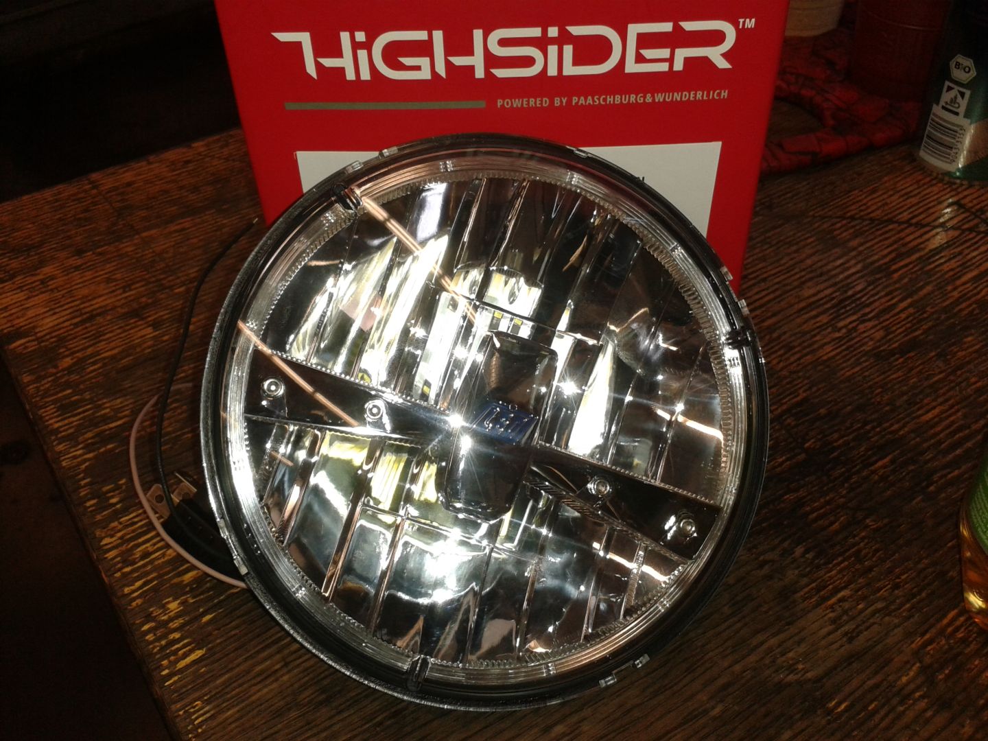

I upgrade my head light with an Highsider 3 LED head light insert.
Plug and Play, best you can get for "less" money
