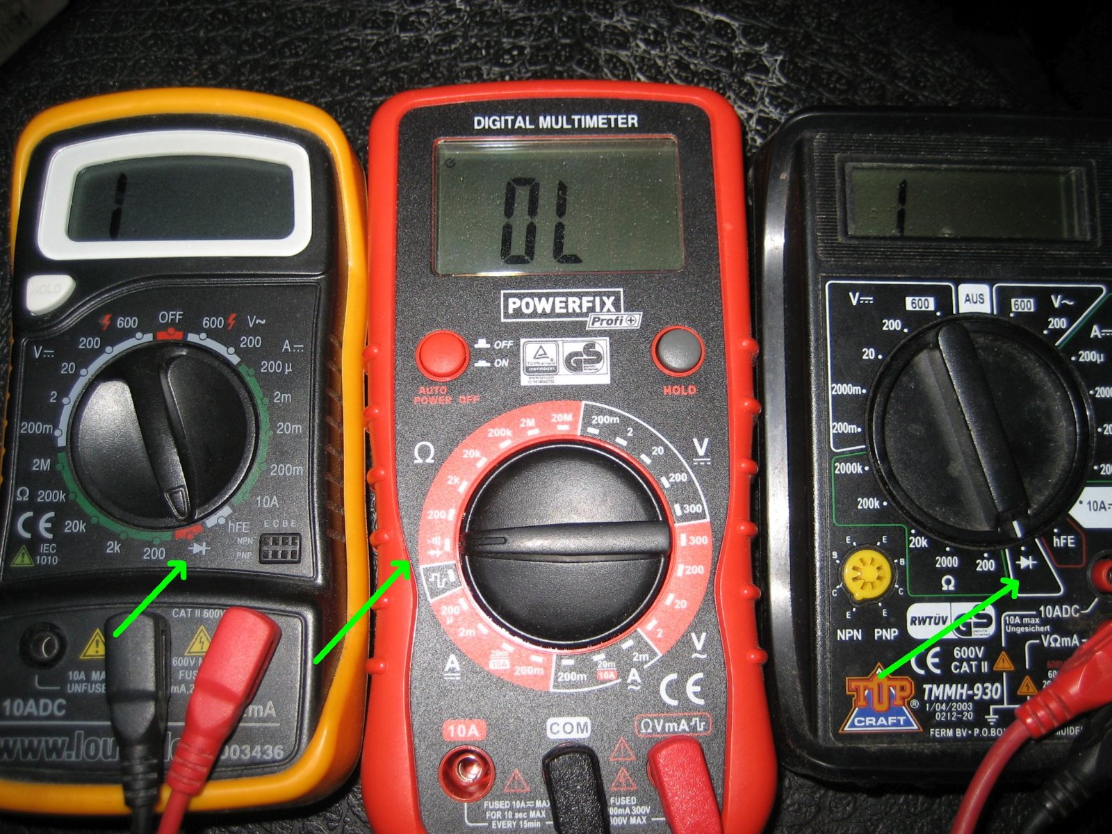

Try to disconnect all wiring harness connectors step by step.
If your Ohm reading goes to --- (endless) you know this the wiring harness you have to search for a hidden shortcut.
Some multimeter have a acoustic beep position that makes it more comfortable.
Remove the battery first or you will destroy your multimeter!!!
