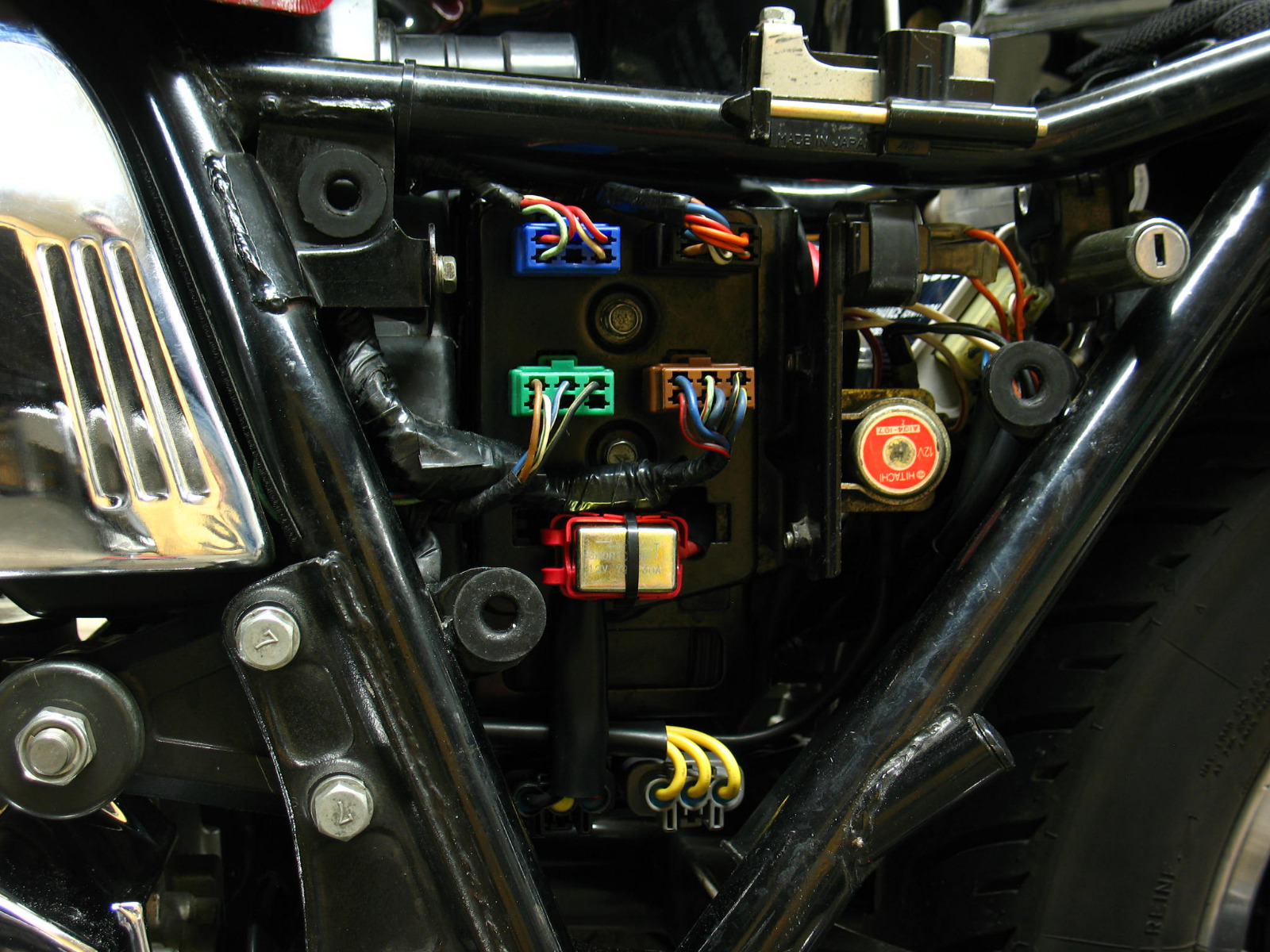

Was riding into town this morning and I saw the voltage drop.
Got home and found this.

It wouldn't hurt to use a series type, but that would have happened with either series or shunting type reg/rec. The shunting to ground happens inside the reg/rec body. It won't directly cause a melted ground like that. That connector melted from a bad connection and the bike's load. The bike's load is pretty constant regardless of regulator type.
Have you used a dielectric grease on the connectors? Sometimes that can wick into the connection and cause a bad connection. I avoid it as much as possible.
Your reg/rec might still be ok if you can restore a good ground connection. And, of course, check the other connections as well. I think Martin has some links to factory connectors, hopefully he will chime in.
Daveo's waterproof connectors look real nice too. That might be a good upgrade.

21 Jul 2018 18:43loudhvx wrote: It wouldn't hurt to use a series type, but that would have happened with either series or shunting type reg/rec. The shunting to ground happens inside the reg/rec body. It won't directly cause a melted ground like that. That connector melted from a bad connection and the bike's load. The bike's load is pretty constant regardless of regulator type.
I thought dielectric grease was supposed to be used on these connections to keep them clean?
