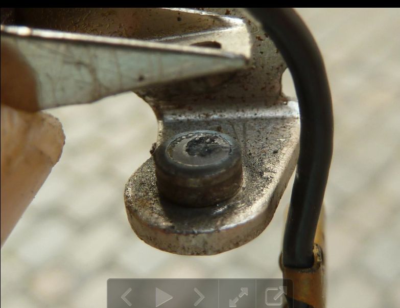

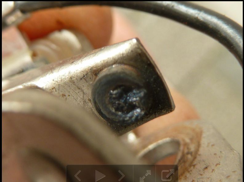

Dirty points will prevent spark (oil,dirt, etc) Clean with a points file (fingernail file) and clean with a folded match book cover. If the points are pitted, it's the condenser that's bad. Heavy blue sparking at the points is the tip off.

Having taken a closer look at the points pic the gap looks suspiciously wide and I wonder if they are contacting when closed.
