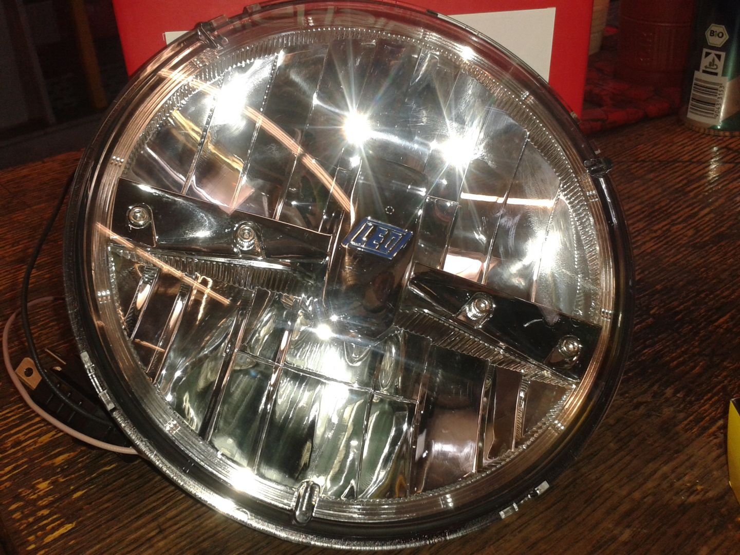

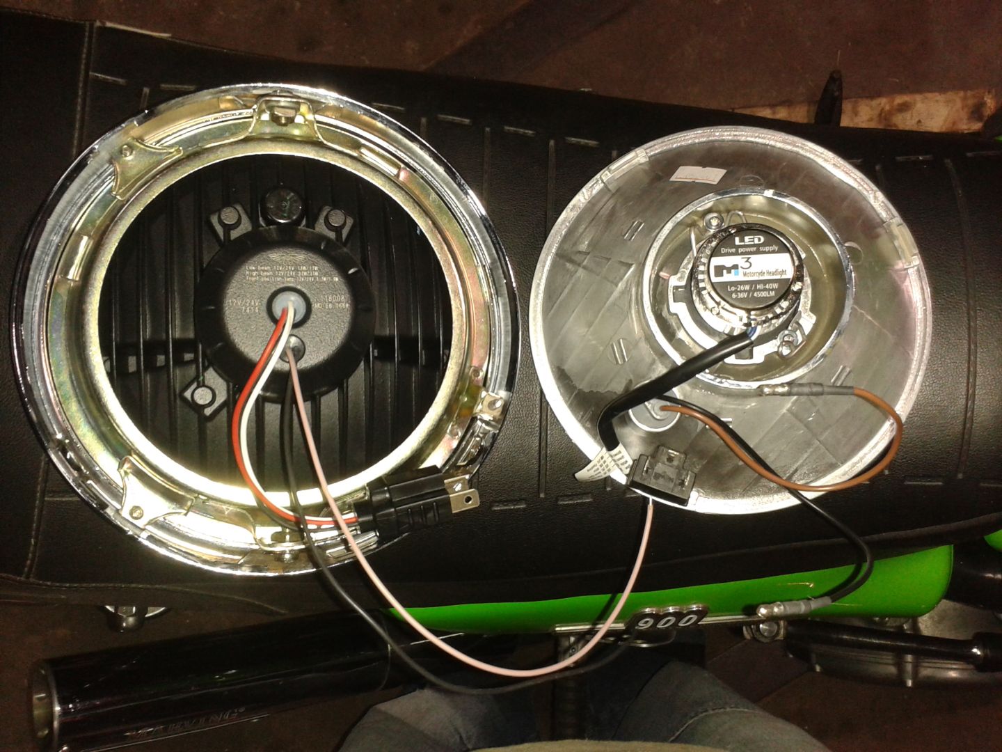

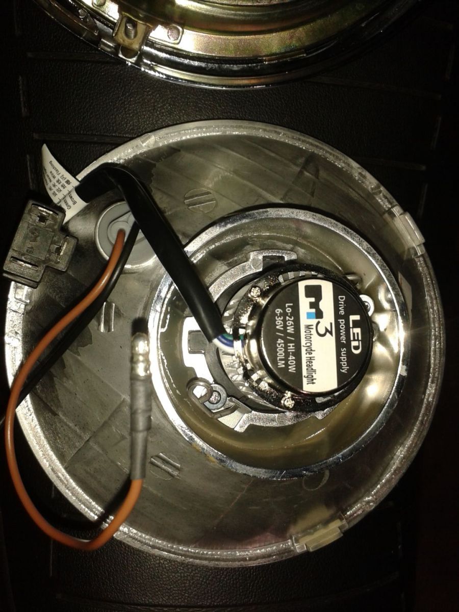

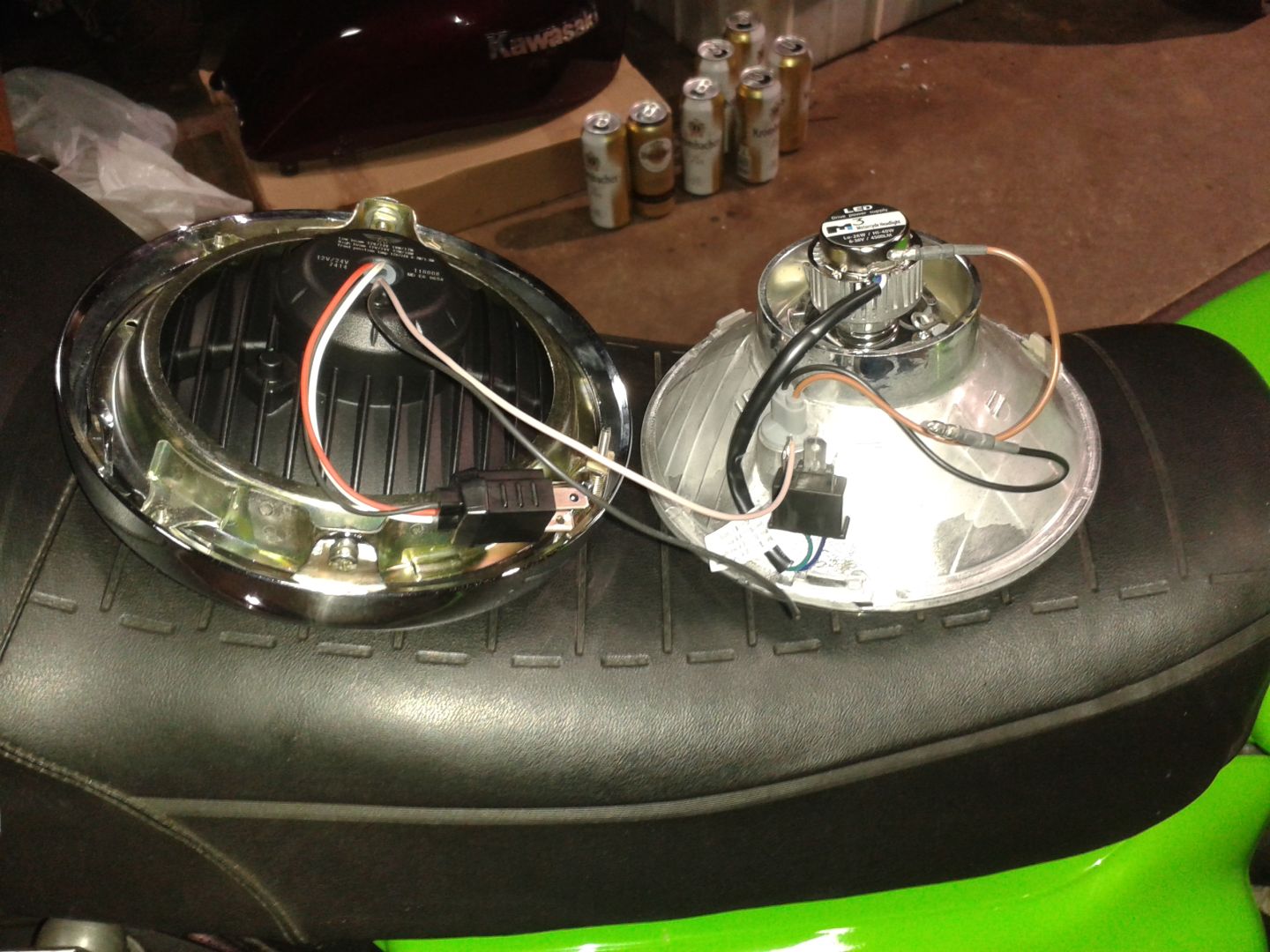

If you upgrade to a new head light (H4) i would go the LED bulb way, (15 Euro for the H4 socket LED bulb)
I do one step more a short time after this and upgrade to an full LED head light system (Highsider TYP3 149 Euro).
Fits plug and play into the head light frame, no mods needed.
