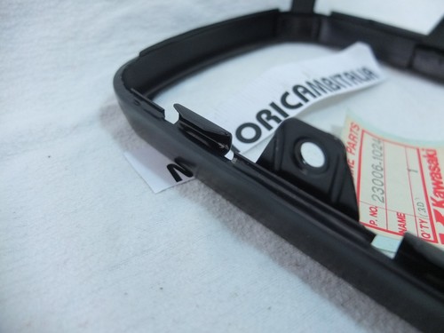

maybe try looking at eebbaayy photos to see what's what. assuming there are 550H headlight components listed.

martin_csr wrote: never mind. my mistake. yours is different.
Yeah I'll give that a shot. I took a quick look and found entire assemblies for sale but didn't try to search for pieces.
Thanks! Anyone with any info/suggestions feel free to chime in

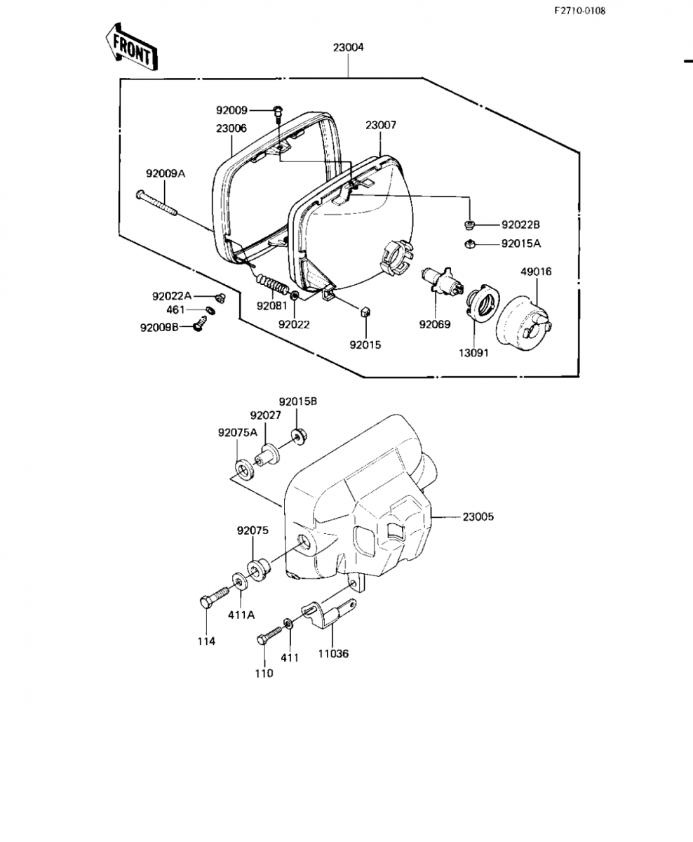

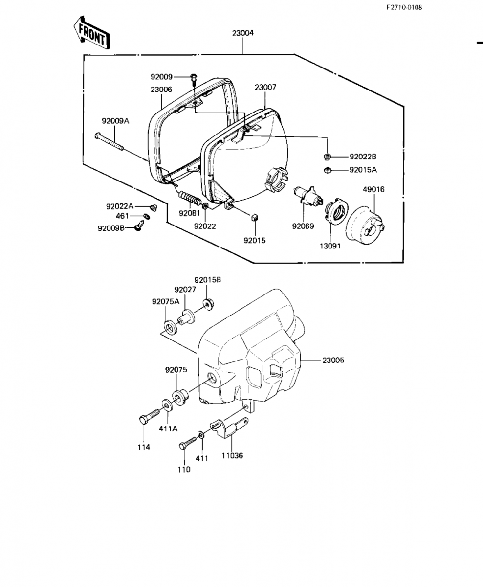

So this is what I have, same part number according to the fiche.
Looks like there's those two tabs on top with a screw in the middle. Seems kinda redundant to me lol, so I guess I'll just try to flip it up and if it breaks it breaks.
