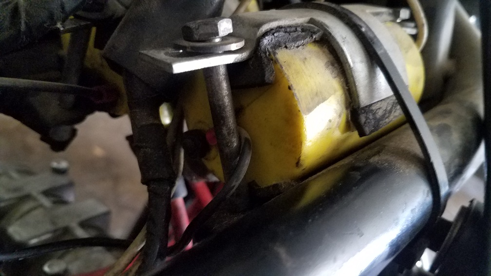

14 May 2018 09:30 - 14 May 2018 09:31what coils are these? they look like accel coils, but use 7mm wires. do accel coils mount the same way/direct drop in? should i get green dynas or will they take modifications to install?
these have no resistors and points ignition.
basically, wtf do i have? and what would be the best replacement for what i have?

The Accel Supercoils usually found on Kz's have the core extended through the center with mounting holes. The ones in your photos don't seem to have the core protruding or visible. Accels have studs for wires to connect to, so they might come with any size wires.

found out what these are. these are "cir cycle" aftermarket coils from the 70's basically a very similar coil to accel.
i just purchased a set of accel 3 ohm coils since they are a direct swap and i want to run a dyna s setup eventually.
