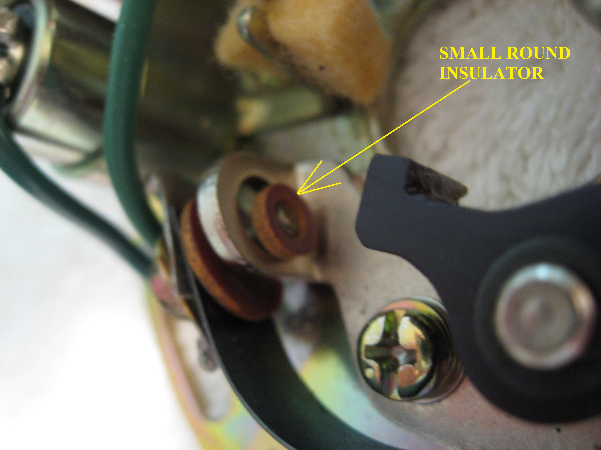

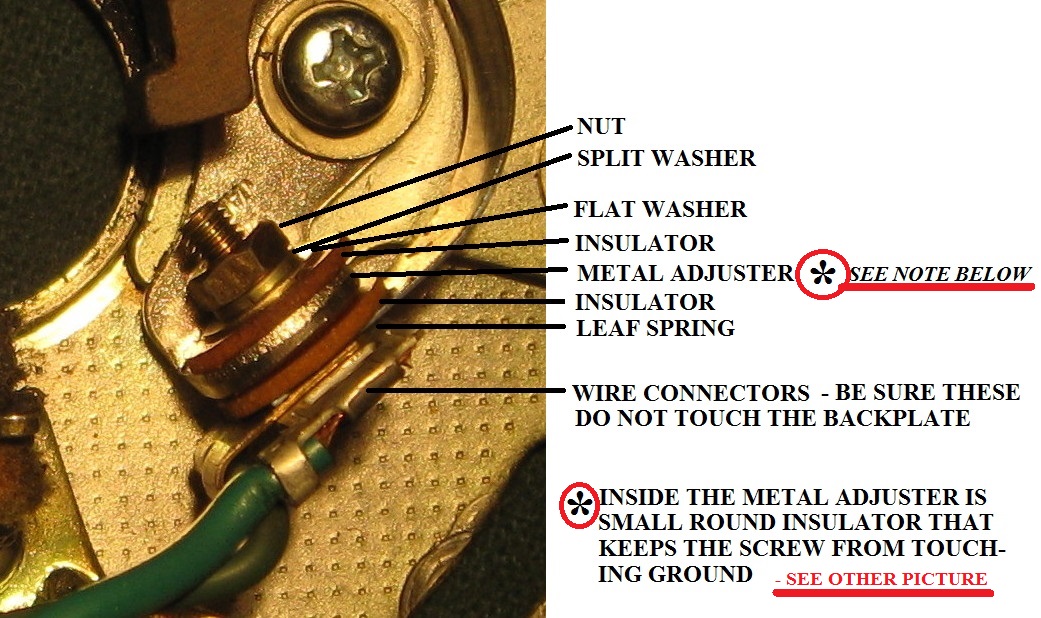

If you forgot one of the insulator washers your points are shortcuted to ground = no spark
The coils are new I have replaced the points and condenser and still no spark.
