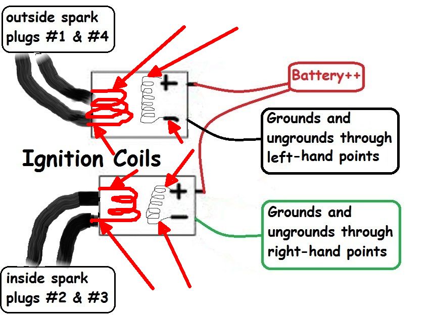

If not the fuses, test the ignition coils primary/secondary circuit for continuity with a multimeter!
