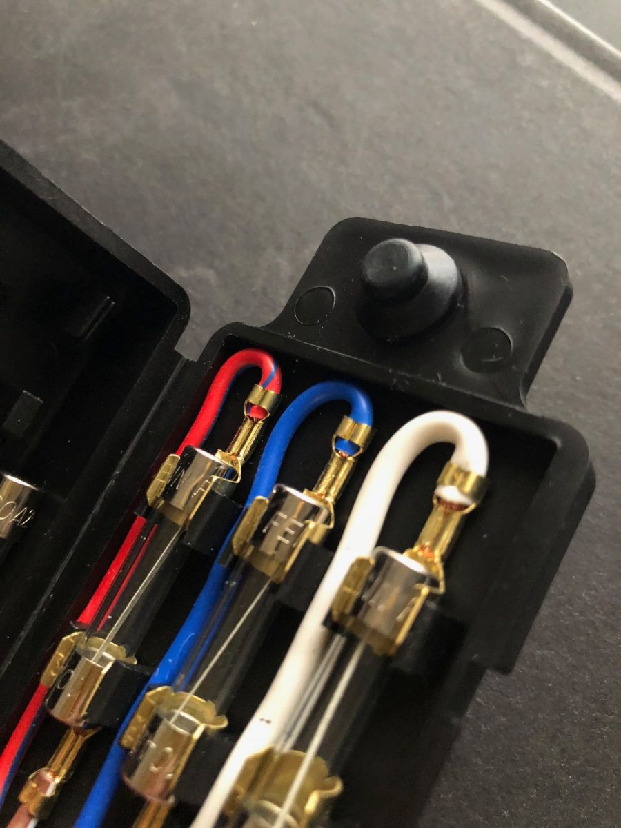

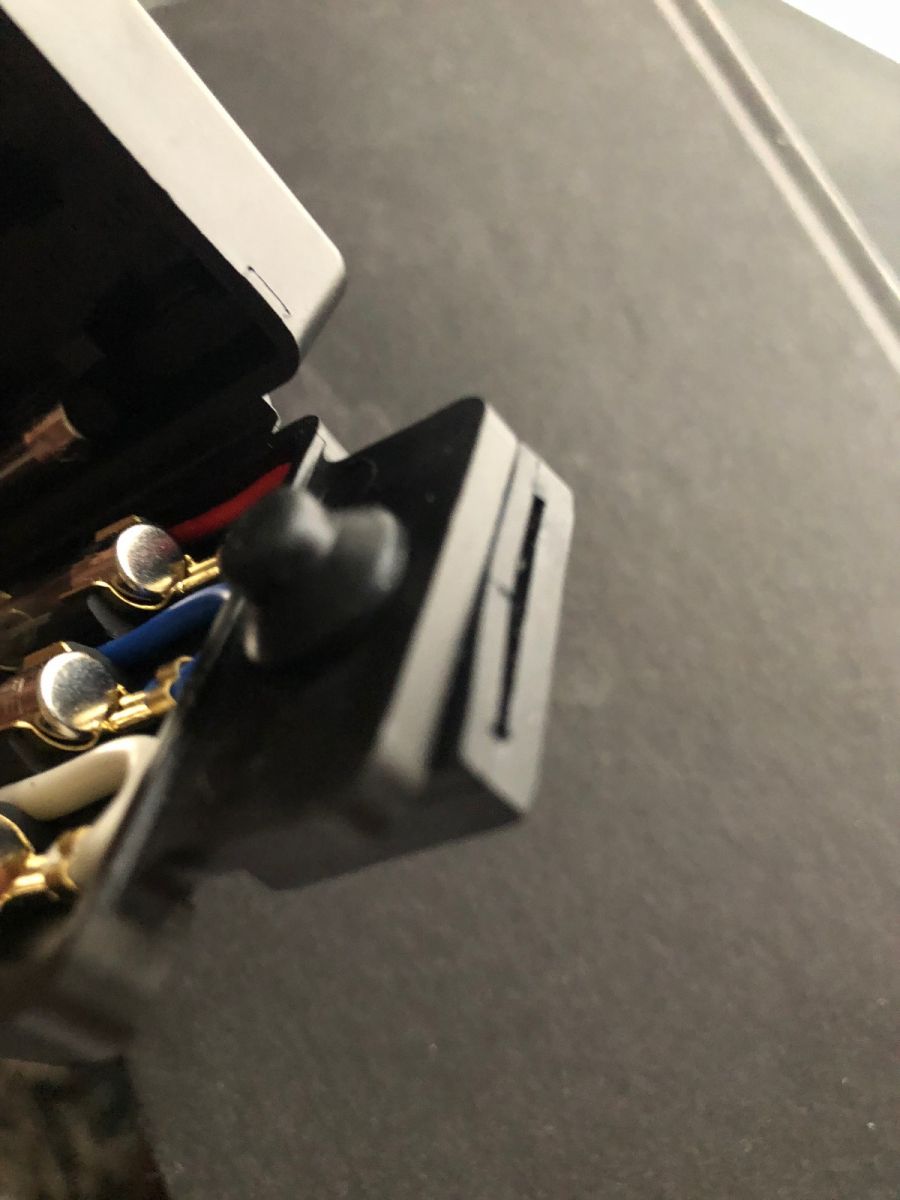

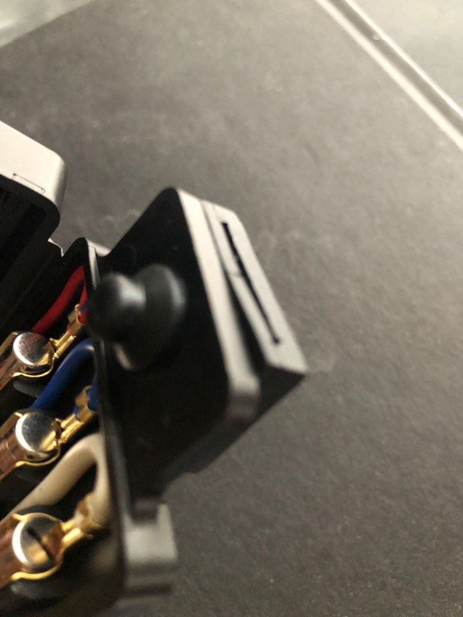

Im home sick. Cant really move around but I can type (what a wicked flu season we've had!)
I got my new fuse box in the mail yesterday, for my KZ650. How does this attach? Does it slide into something?
See pics:

The rubber piece holds onto a metal tab. The tab slides into the slit in the rubber.

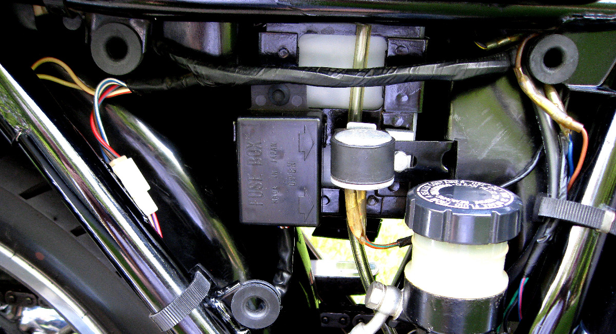

Under the right hand side cover there should be a bracket. Toward the rear of the bracket there should be a flat tab facing upward. The wide slot on the fuse holder slips onto that tab as shown below. Ed

650ed wrote: Under the right hand side cover there should be a bracket. Toward the rear of the bracket there should be a flat tab facing upward. The wide slot on the fuse holder slips onto that tab as shown below. Ed
Thanks. Your bike is super clean!
