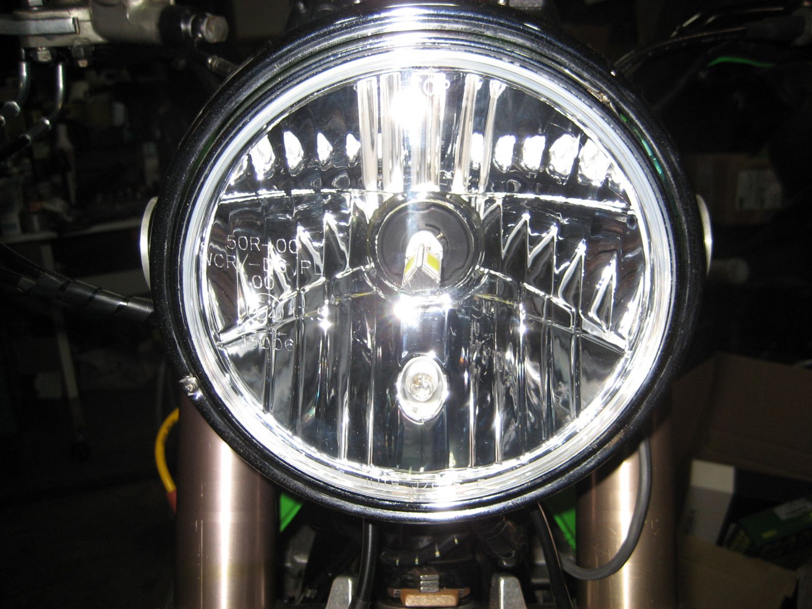

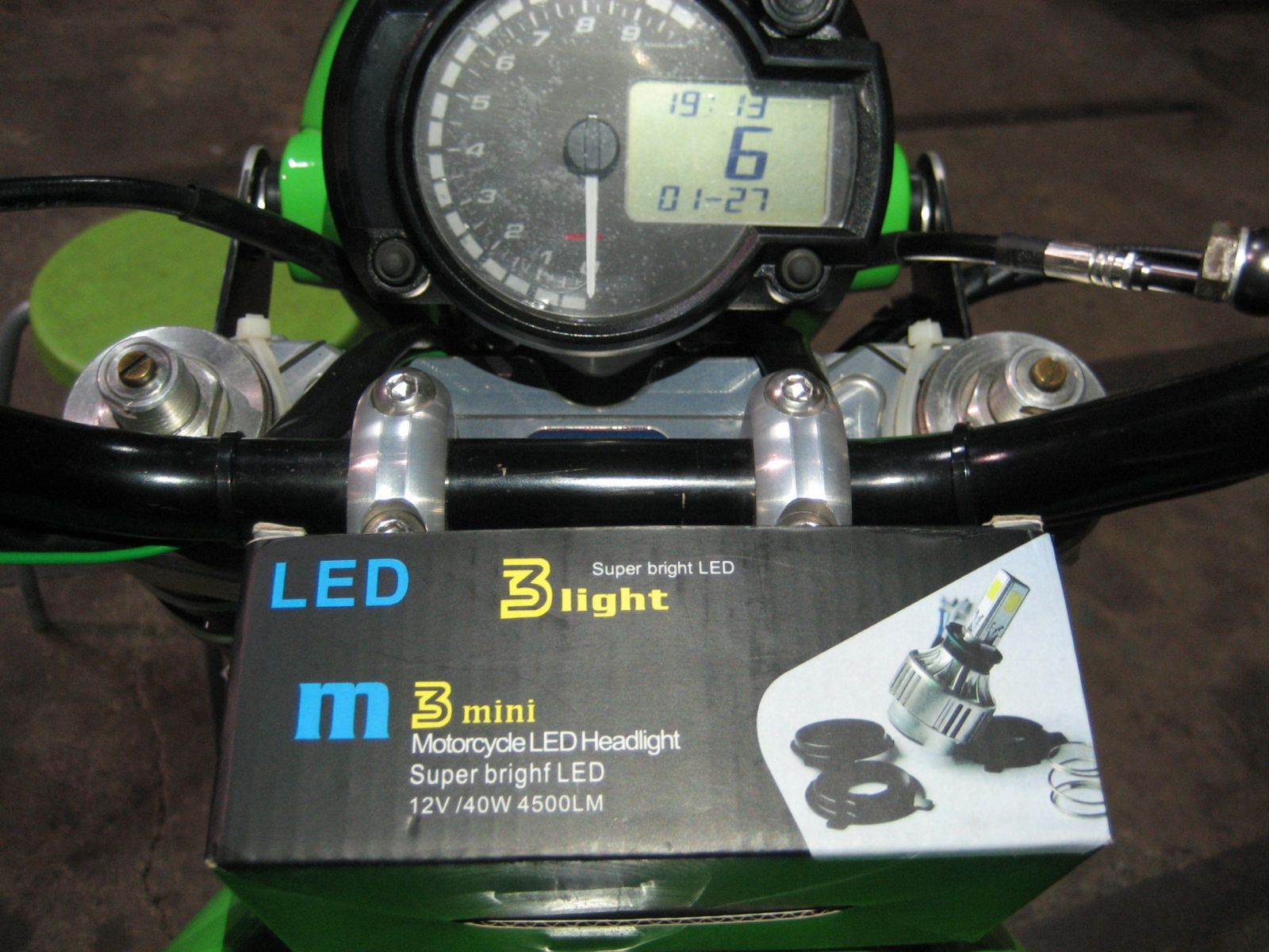

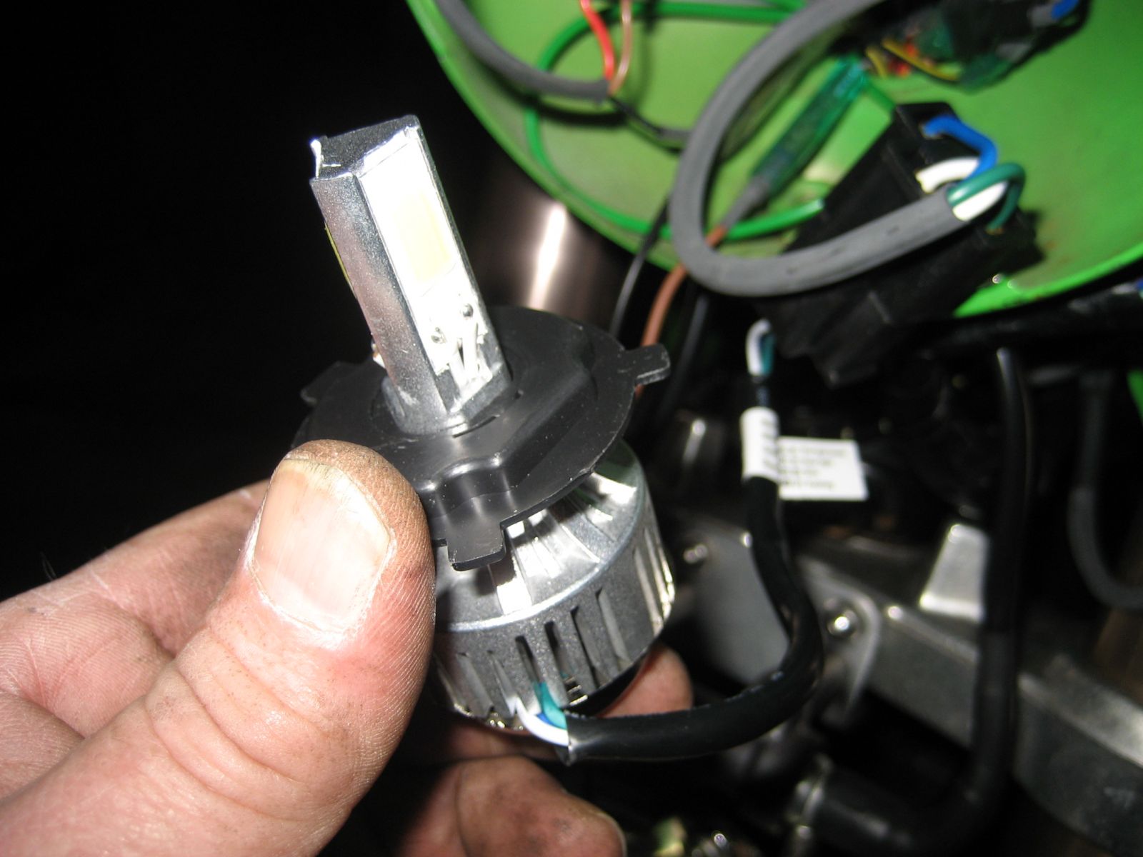

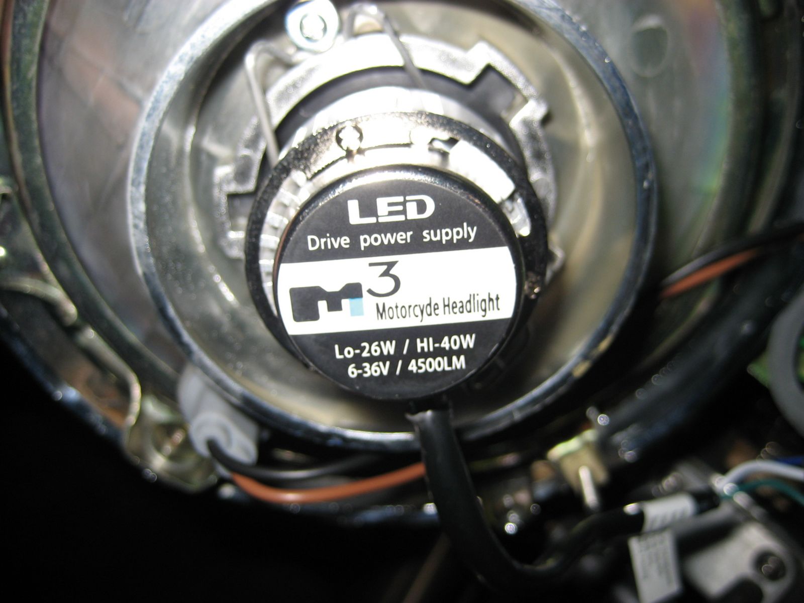

I use this H4 Halogen bulb style LED in my Z1B head light.
The LED has a little fan for cooling and the set comes with different adapters for the bulb installation.
