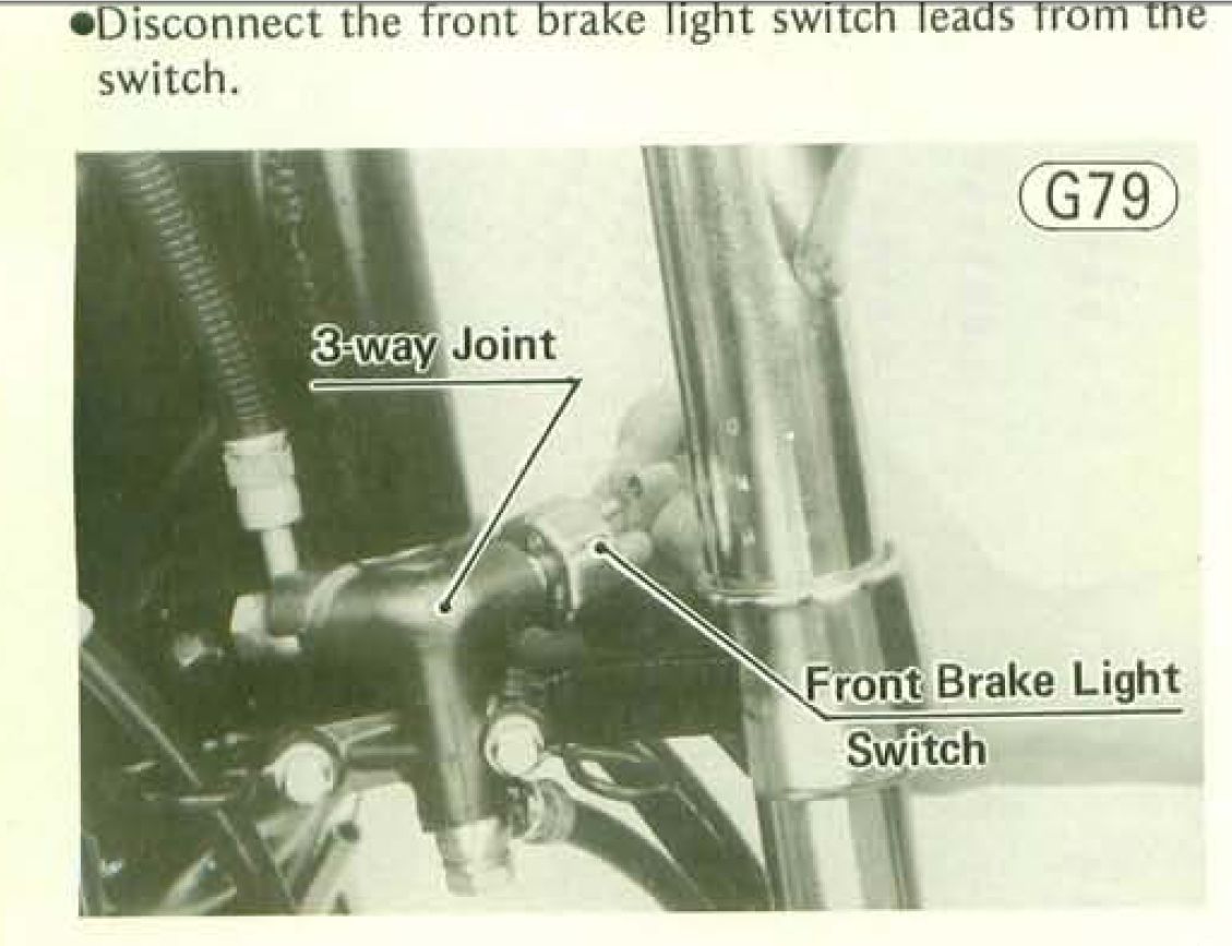

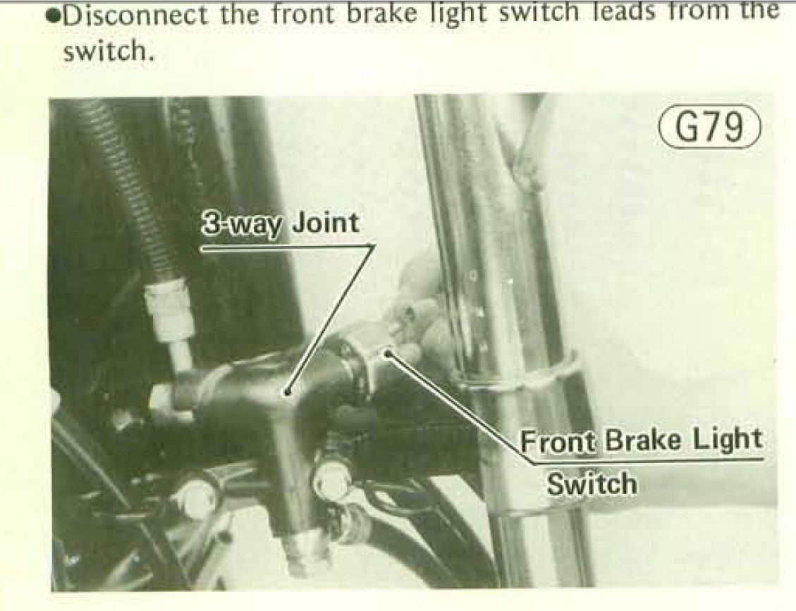

Neutral switch location
Shortcut the neutral switch connector to the engine housing or any bare metal part (neutral light should be come on).
