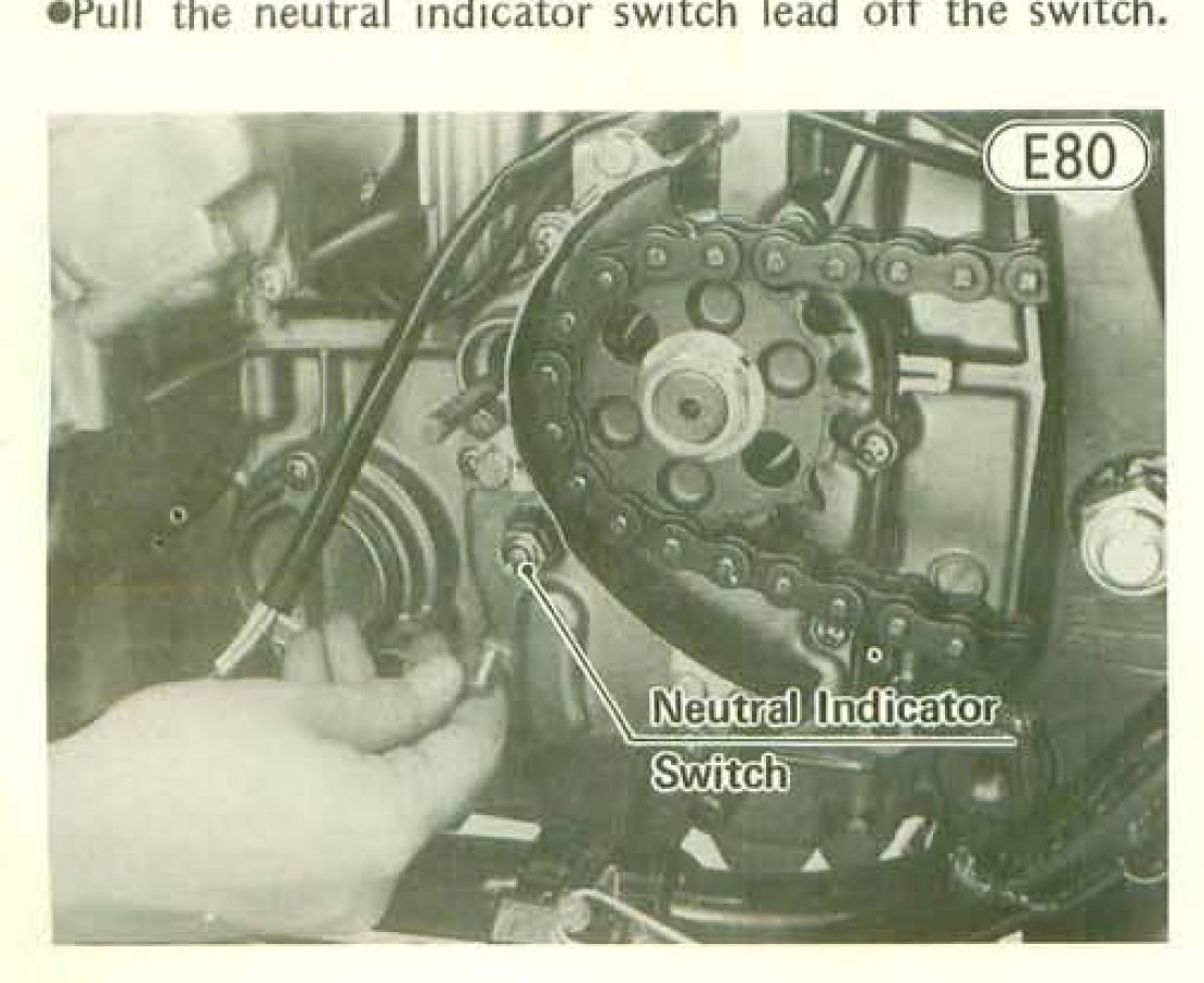

Neutral switch location
Shortcut the neutral switch connector to the engine housing or any bare metal part (neutral light should be come on).

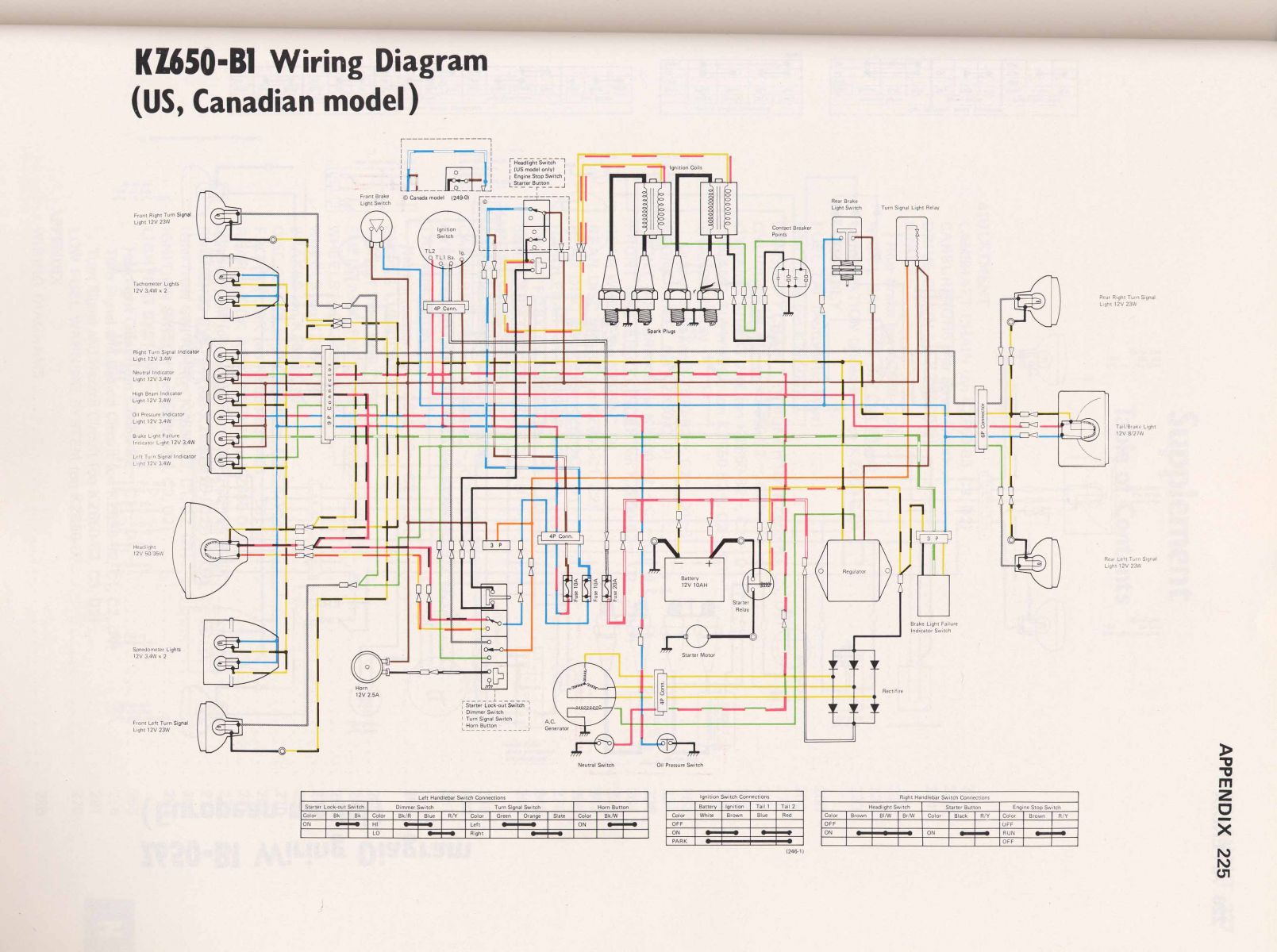

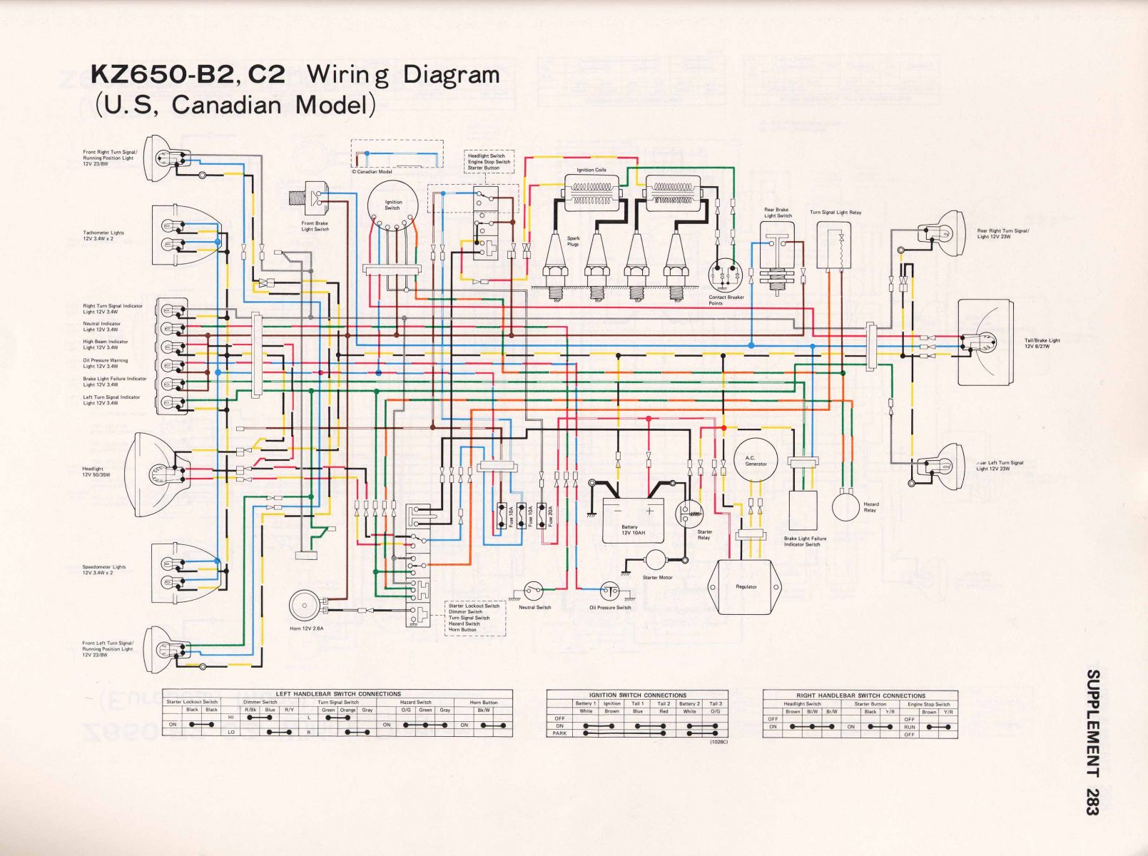

Wiring Diagrams

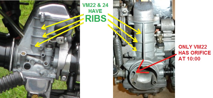

Your bike is either a 1978 KZ650-B2 or a 1978 KZ650-B2A. The B2A models used 22mm carbs rather than the normal 24mm carbs. To tell the difference you can probably hold a small mirror in the airbox to see the rear of the carbs. The image below show the extra orifice that the 22mm carbs have.
