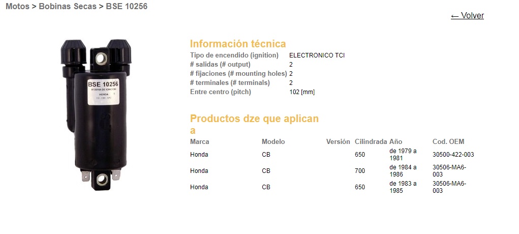

You can search for DZE "bobinas secas", they sell a replacement too.
Take into consideration, EMGO is an aftermarket supplier. Not a high perfomance parts one. Soy there is a chance, local Pietcard and DZE are the same coil as EMGO.
