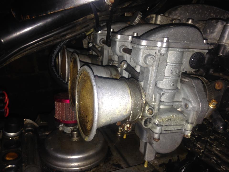

, im determined to get this right, the bike is running open cone filters which i personally think the bike is not ment to run them, i come out this morning to smell a very strong smell of fuel and noticed i had fuel coming out of the 1st carb closest to myself in the pick it was dribbling out of the the bottom connection like where you empty the bowl,
here is a pic of my bike and the carbs the bike is a 1980 650 frame but a 1980 550 engine but its not running on points so would make me believe its older than 1980 as they had points and condenser

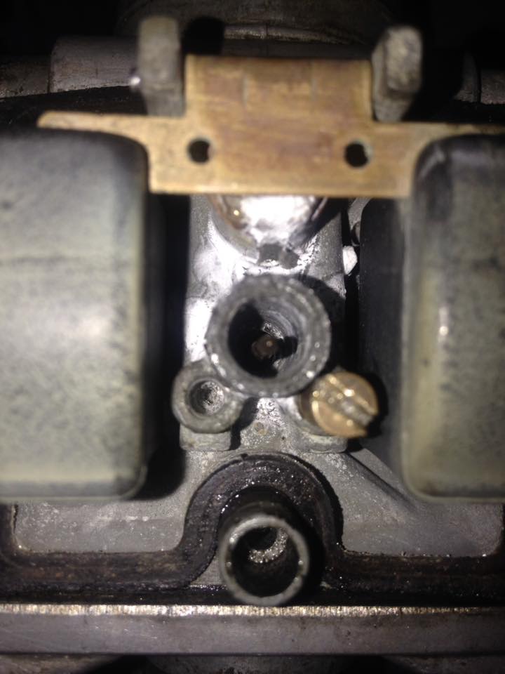

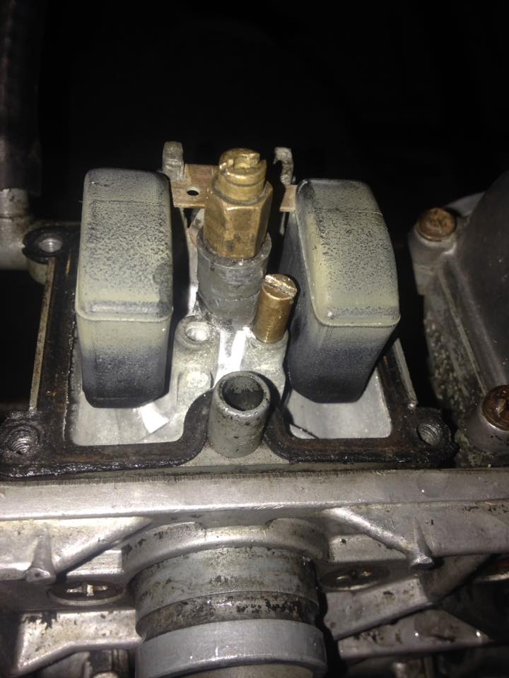

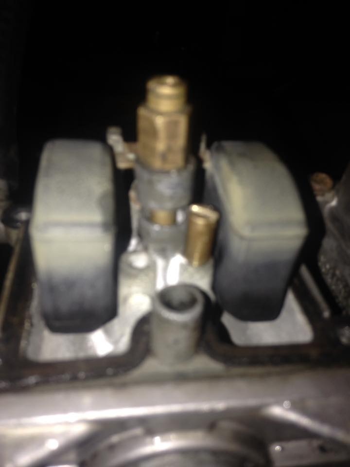

Hey guys so cleaned the carbs and everything and noticed who ever re-installed the carbs last time had not put them on properly at all, but then when cleaning on the 3rd carb somone had put some fuel line inside and then i realised why and this is why
so i can eaither use some form of chemical metal or try and find other carbs, what do you guys reckon ?
Attachment not found

The cheap solution, try to clean the area around the broken part and glue it with JB weld or fuel resistant tank sealer.
The best and more expensive solution is a good used set of carbs at the common market places like E-Bay.

In the U.S., the 1980 Kz550's came with points on the standard A model, but the Ltd. C model came with electronic ignition.
The Tk22 carbs can run well with pods or even no filters as long as it's jetted properly.
It seems you have some more important issues on those carbs though. I can't see the recent photos right now, so I'm not sure what's broke, but if it's the brass stand-pipe inside the bowl, some people have fixed it by sleeving some heatshrink over the cracked pipe.

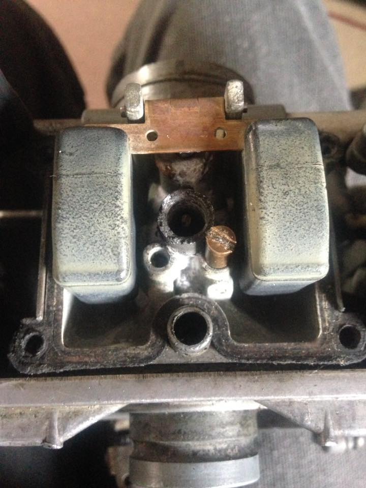

Lot of problems there...
One, the bowl vents appear to be capped off. That will cause a fuel flow issue.
That jet holder seems to have some home-brew seal. Are the threads messed up in the carb? If so, you can probably get a tap for the body.
It needs the proper oring.
That pilot jet head looks pretty worn from maintenance, but it should work as long as it's clean or can be cleaned.
Here's a TK22 website for some info not found in the manuals.
s3.amazonaws.com/gpzweb/TK22mainPage/TK22mainPage.html

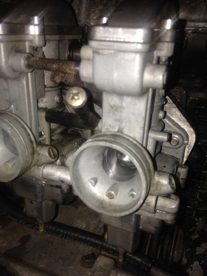

thank you for that loudhvx. the jet holder is snapped off but the threads are fine i was wondering if i used JB weld if i could glue it back on ?,
i have just took a few more pics i put a bit of wire inside the bowl vents to make sure it was cleaned out, i cleaned the main jet out with compressed air.
