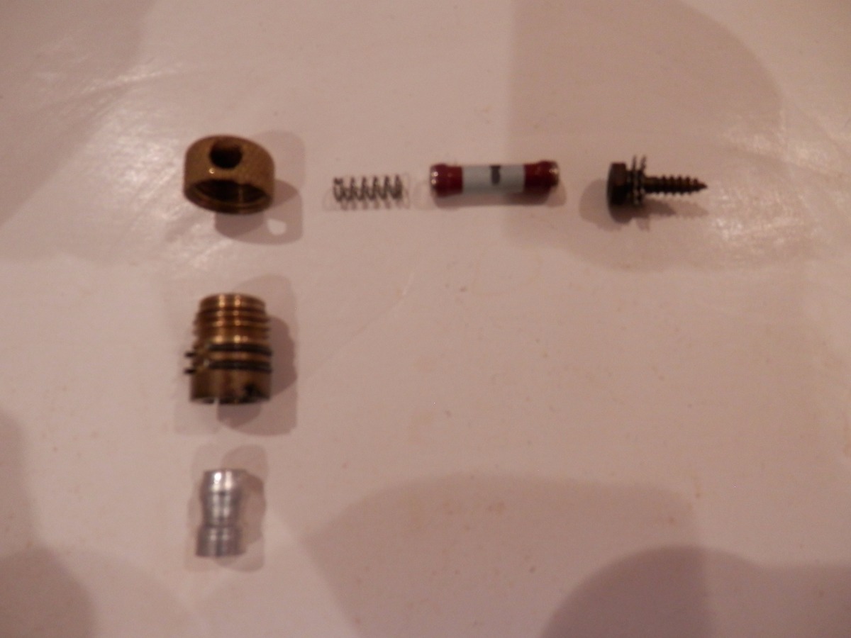

If you suspect the misfire is just one cylinder then the plug, plug cap and HT lead might be worth checking out. A few years back I had a misfire and found I had a faulty plug cap. Resistance between one end of the plug cap and the other was infinity. I replaced all caps with new ones but decided to dissect the problem one for interest sake. Below is a pic of the internals plus the silver thingy which fits the spark plug top. Funny thing thing is that the resistor (red white and black thingy) measured 5k ohm (which it should) when out in the open but I had no reading when everything was together.
Your problem might even be solved by something as simple as trimming the HT lead by 1/4 inch and re inserting the cap in the HT lead
Power for the coils comes from the right side handle bar switch and joins the main harness via a 4 pin (at least it does on my 750) connector under the tank. These connectors get brittle from the heat and I had one crumble and the bike died. If your problem is here then I would think both coils and all cylinders would be effected but you never know until you look.
Just a couple of suggestion to keep you occupied over the winter
