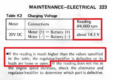

Now here's the part I find difficult to understand - In the beginning of this thread KawasakiOwner stated "I have Kawasaki's original book". So given that he has it, has he even bothered to read it? The manual is quite clear about how to test the charging system and what the readings should be, so how can he not know that 16v is too high unless he didn't bother to read the manual? Sorry if I sound like a prick, but I seriously do not understand why anyone with the manual would not bother to read it when troubleshooting a problem.
Here's a cut & paste directly from the Kawasaki Service Manual that covers the KZ750-L1 that shows 16v is too high:

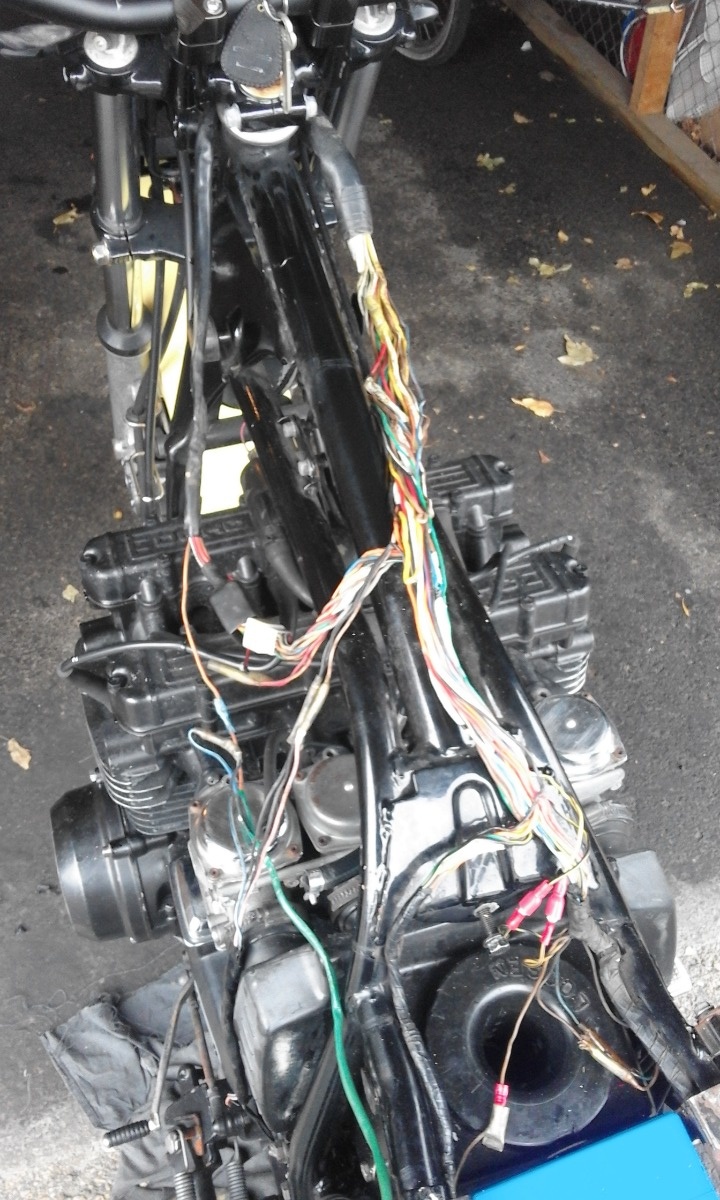

The Brown wier was not connected now thé volt is 15.30
Im going go look over the electricsystem. Have 3-4 wiers that not is connected.
