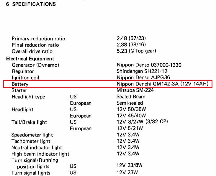

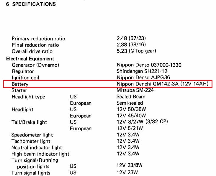

Agree. Personally I wouldn't risk creating electrical problems by ignoring the bike's specs. I don't have the specs for the 1983 KZ750 twin, but they may be the same as the earlier KZ750 twin as shown below. Ed

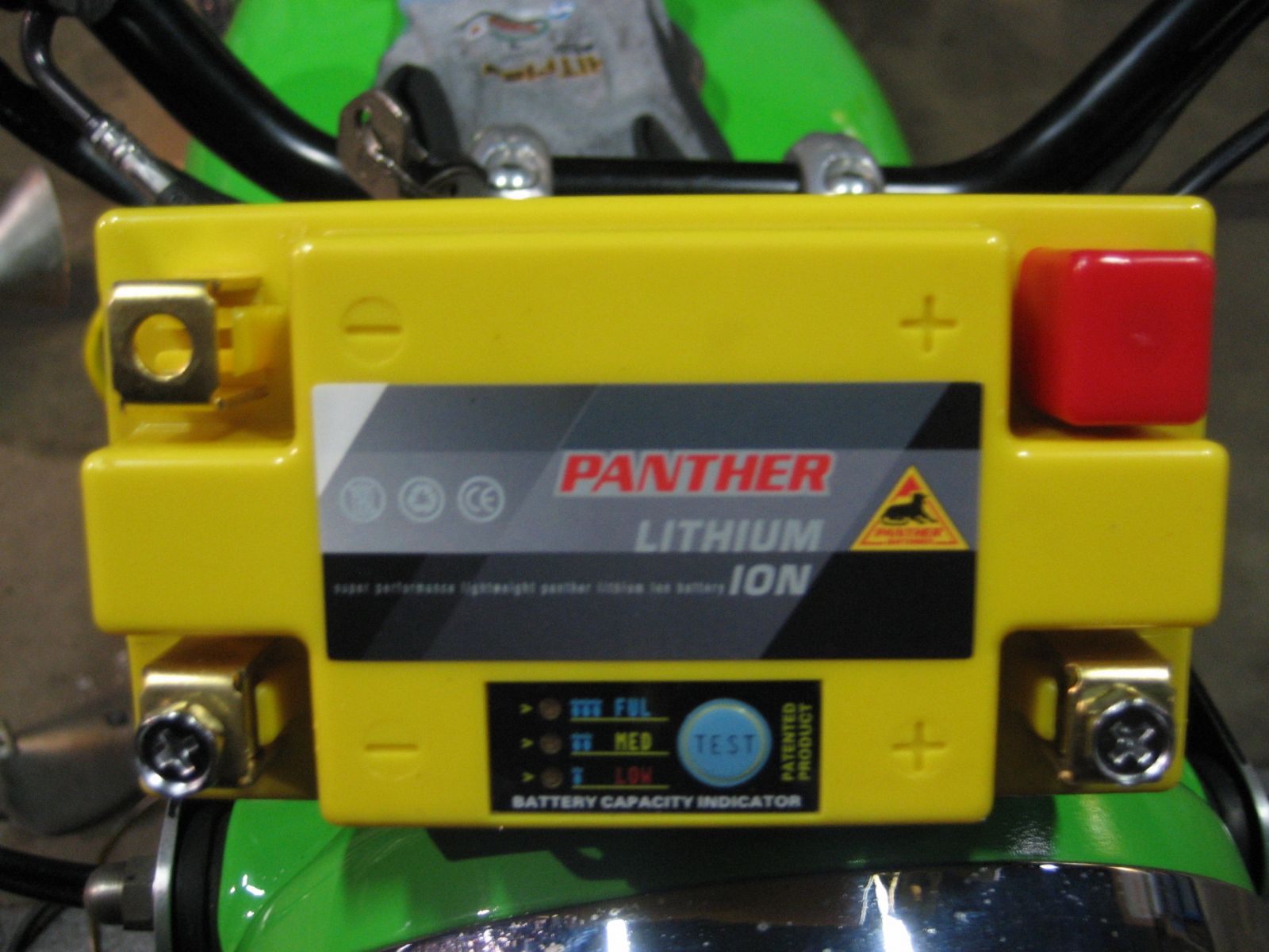

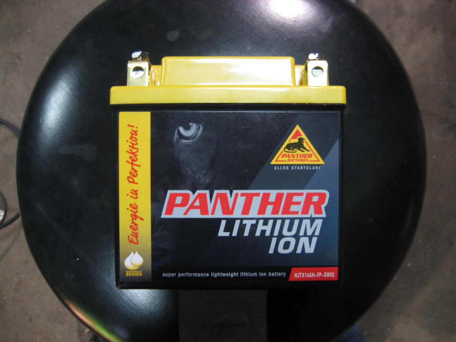

I use a LI-ion battery on my Z1 900 project bike with 14 Ah
Weights only 0,9 kg, is smaller in size and the starter motor pulls like hell!!!
Can mount in every position and is fully charge in 30 minutes.
The same 14 Ah lead/AGM battery weights 4.9 kg
Any questions?
