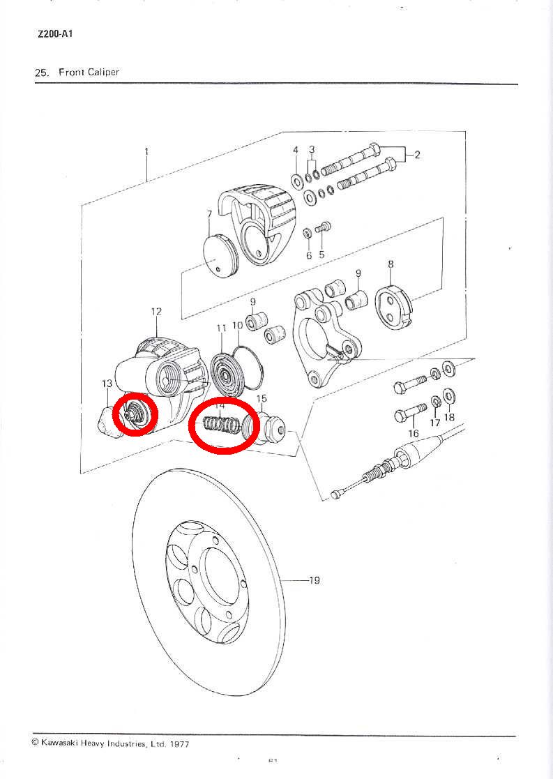

Re: Engine R/pm effects light brightness
06 Sep 2017 22:21 - 06 Sep 2017 22:24

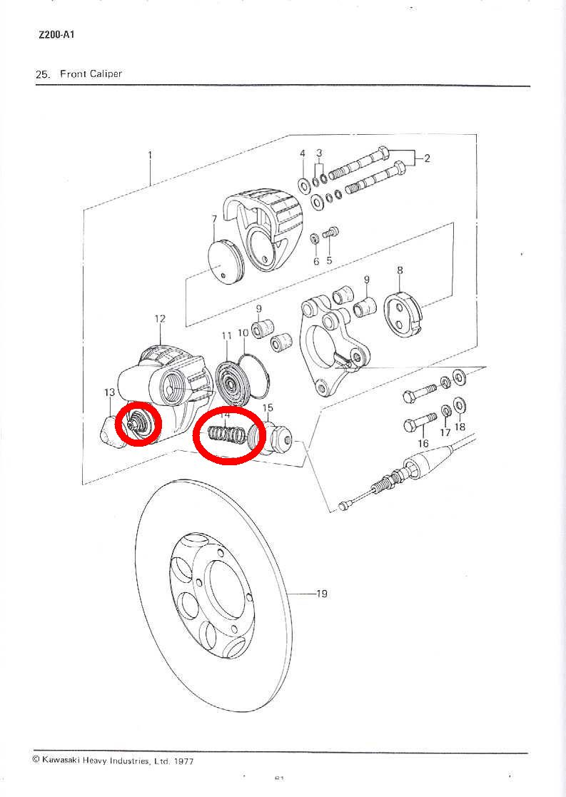

His KZ200 has no hydraulic front brake.
It could be the return spring #14 is weak or he has adjust the front brake piston under #13 cap (screw and nut)
