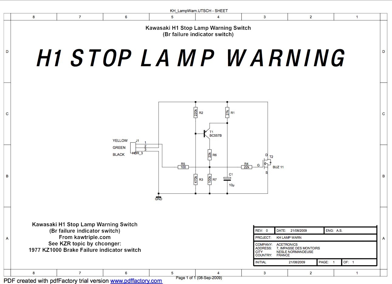

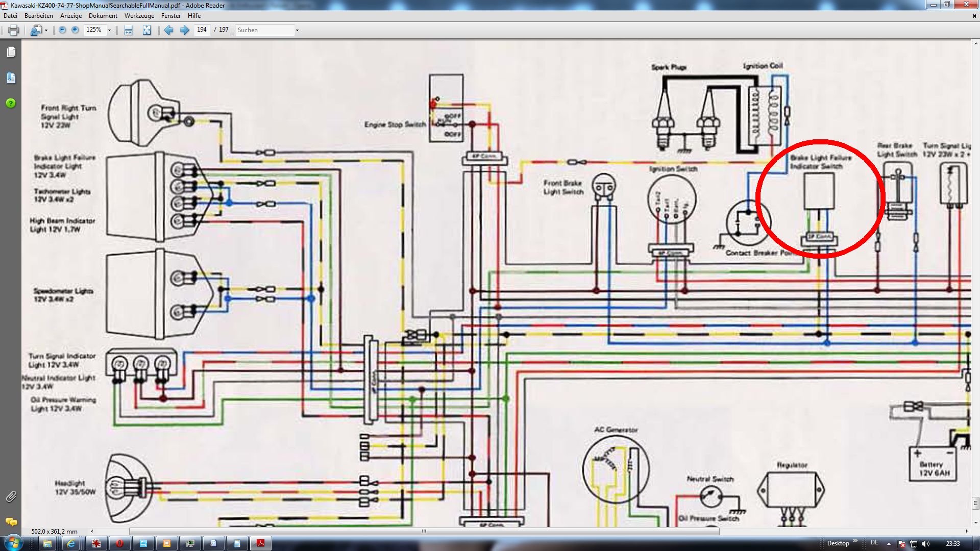

Okay, i try to explain this with my less English knowledge
Your LED stop light need less current = 2 - 5 Watts
A stock stop light has 21 Watts and need more current
In the main wiring harness under the tank is a connector with a so called "Brake Light Failure Indicator Switch"
He controls the current flow if your stop light bulb is okay (as a resistor in the weiring circuit)..
If the bulb of the stop light is shot he will let flashing the stop light failure indicator light when you switch the ignition on.
A LED is a diode and has no resistance like a resistor and has less,(or no current flow if not in use) current flow.. The Brake Light Failure Indicator Switch indicate a bulb failure. and act like a turn signal flasher relay now to show you your bulb is shot.
Last edit: 31 Aug 2017 14:43 by Scirocco. Reason: Ad wiring diagram

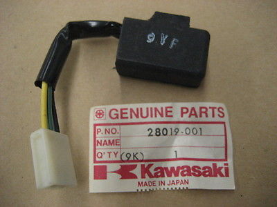

this will be very helpful information. Thank you. I'm wondering now if you actually have pictures of what the brake light failure indicator switch actually looks like and what to do once i locate it.
- Posts: 8018
- Thanks: 1645
Re: 75'-78' kz400 stop light flashing
01 Sep 2017 13:57 - 01 Sep 2017 13:58
Get the full part number at Partzilla, then check it on eebbaayy. There may be one or two listed.
Partzilla -->> OEM -->> Kawasaki -->> motorcycle parts -->> year -->> model -->> chassis electrical equipment
Note: the brake light failure indicator switch is a safety feature & lets you know if the brake light is not working. possibly keeping you from getting rear-ended.
