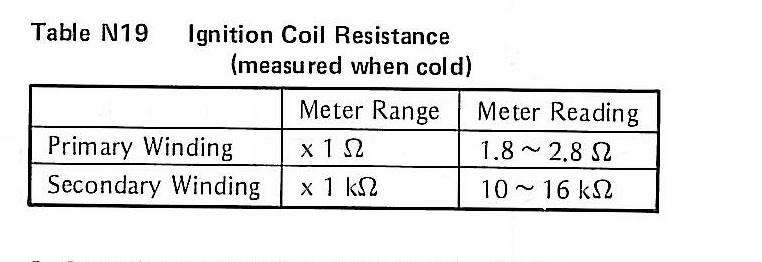

In the links of my signature, you can get the various service manuals. You should grab all of them for completeness and in case of errors so you can compare them.
The coil info is in the "white" base manual under the 1980 supplement for the electronic ignition models. The "red" base manual has it, but unfortunately has it wrong. That is why I recommend having all of the manuals to compare info.
This is the correct specs for the 550 electronic ignition coils (from 1980 supplement of the "white" base manual).
The factory coils for the 81 Kz550A2 are nominally 2.3 ohm coils, but they might measure up to 2.7 ohms or higher if hot.
You can get 2.2 ohm dynas, or you can find coils on ebay that are exact replacements for the stock coils, but make sure to get the 2.3 ohm ones and not the 4-ohm ones (4 ohm coils would be for the points bikes, like the 80 Kz550A1). As Corey posted links to, you can also use 3 ohm Accel Supercoils or 3 ohm green Dyna coils, but they cost more.
