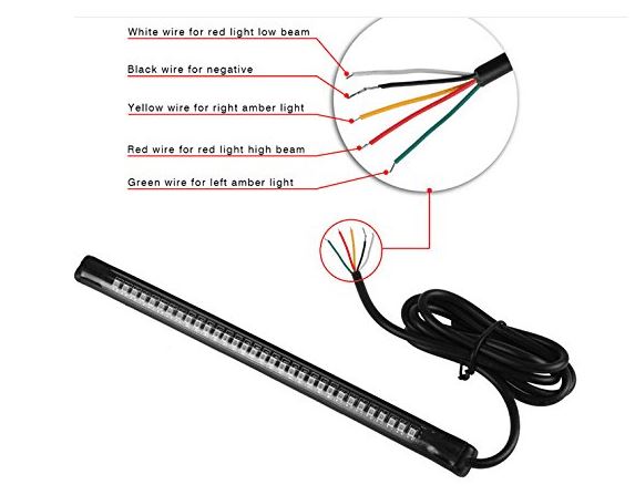

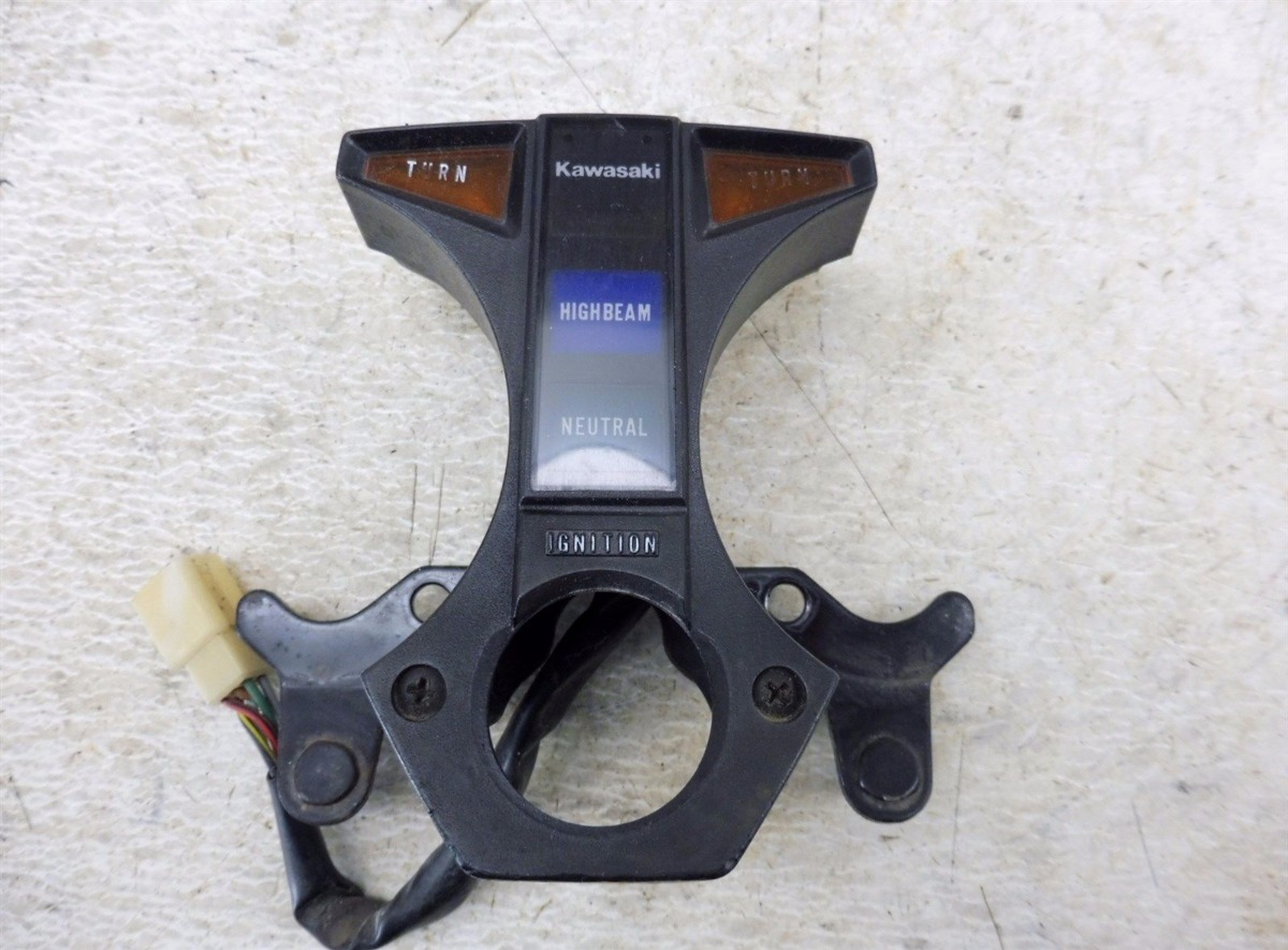

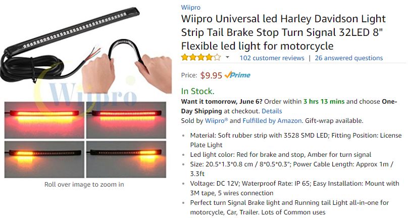

I recently purchased front LED Blinkers and a flexible rear LED tail light that has blinkers built in for my 1980 KZ440A LTD. I had done some research and thought I found a correct flasher relay for this setup but I'm having issues with getting the front and rear blinkers to work when the front or rear brake is applied. I have checked all my ground wires and everything seems to be in order. The only wires I'm uncertain of are the two that came off the original relay. Does anyone know which color wire is for the Input or output? Below are pics of the blinkers, brake light and relay. I'm not an ace when it comes to electrical so I appreciate any help. Thanks.

Also, if your gauge cluster (assuming you have one) has any incandescent lights this might affect the operation of that flasher relay.

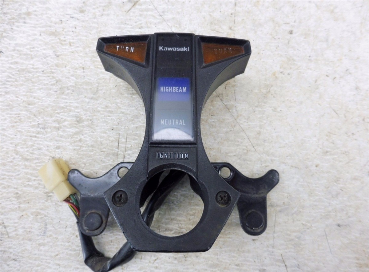

- c_loughridge
- Posts: 26
- Thanks: 4
Re: Blinkers Stop Blinking When Applying Brakes
09 Jun 2017 05:08
I removed the center indicator light cluster If that is what you are referring to. I wonder since the center cluster has blinker indicator lights and it's no longer connected that I might need to run a ground wire from the open connector to the bike.

Well problem solved. After all the guessing and looking for grounding issues it came down to a faulty relay I bought off of amazon. I purchased a different one from "Superbrightleds.com".
