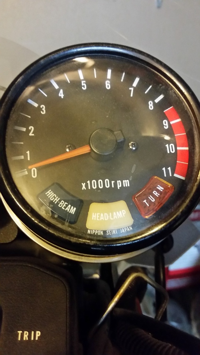

Hello,
I have a 1982 Kawasaki KZ 1000 LTD. I notice a fluttering of the tachometer gauge when I am running at speeds above 45 mph and don't notice this a low speeds. Does anyone have any idea what might be causing this or how to resolve. The engine is running beautifully!
Thanks
Marc
Thanks
Marc

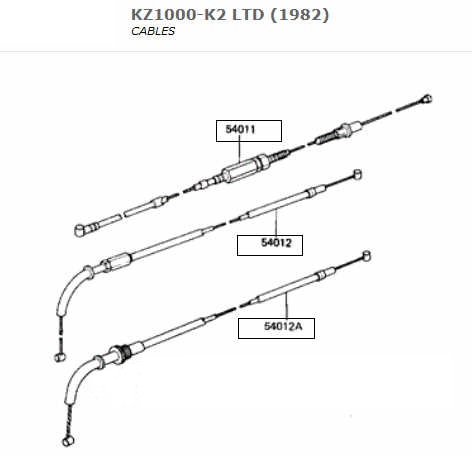

04 Jun 2017 17:19SteelerStewart wrote: Thank You Ed. I will try this!
Funny!
I had replied suggesting that you lube the tach cable, but then after looking at the parts diagram I saw that the 1982 Kawasaki KZ 1000 LTD didn't come with a tach cable so I erased my reply. Sorry about the confusion. Ed
- Posts: 23784
- Thanks: 3048
Re: Tachometer Fluttering at 55mph
04 Jun 2017 17:32
So it is electronic. Bad diode somewhere.
