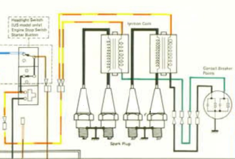

Figured it out. I took pictures of a bunch of stuff before I took it apart.
There are 3 wires coming out of the points. Black, green, and blue/red. These wires go up to the coils. When putting it together,
I naturally wire the same color to color. My brother looked at the picture I took prior to disassembly. He said, " oh look at that
they have green to black and black to green!!!!! WHAT!!!!
I switched wires and it fired right up. Has anyone seen this? Is this the correct wiring? According the to wiring diagram
it should be green to green and black to black.
- jdvorchak
- Posts: 398
- Thanks: 50
Re: Plugs Spark - Won't start
02 Jun 2017 20:27

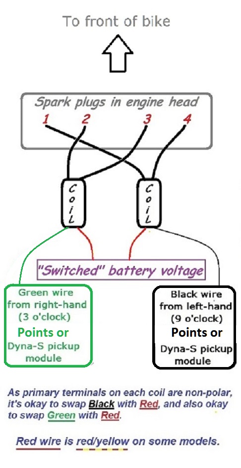

that tells me you have the coils wired backwards from stock. And that also means the spark plug wires are crossed. If it runs leave it alone. But if you swap the coil wires to black to black and green to green you will also have to swap the spark plug wires 1&2 and 3&4.
Wired correctly the left coil fires 1 and 4 and the right side coil fires 2 and 3.

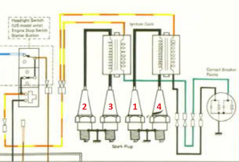

KZ650
The large fours, Z1, KZ900 and KZ1000, are wired the same, but with the coils being mounted in the reverse positions
(i.e., green-wired coil is mounted on the right, firing the two middle plugs which are #2 and #3).
The KZ650 wiring diagram is confusing because the plugs as pictured aren't in 1-2-3-4 order and aren't numbered.
Below, I have added the plug numbers in red print.
