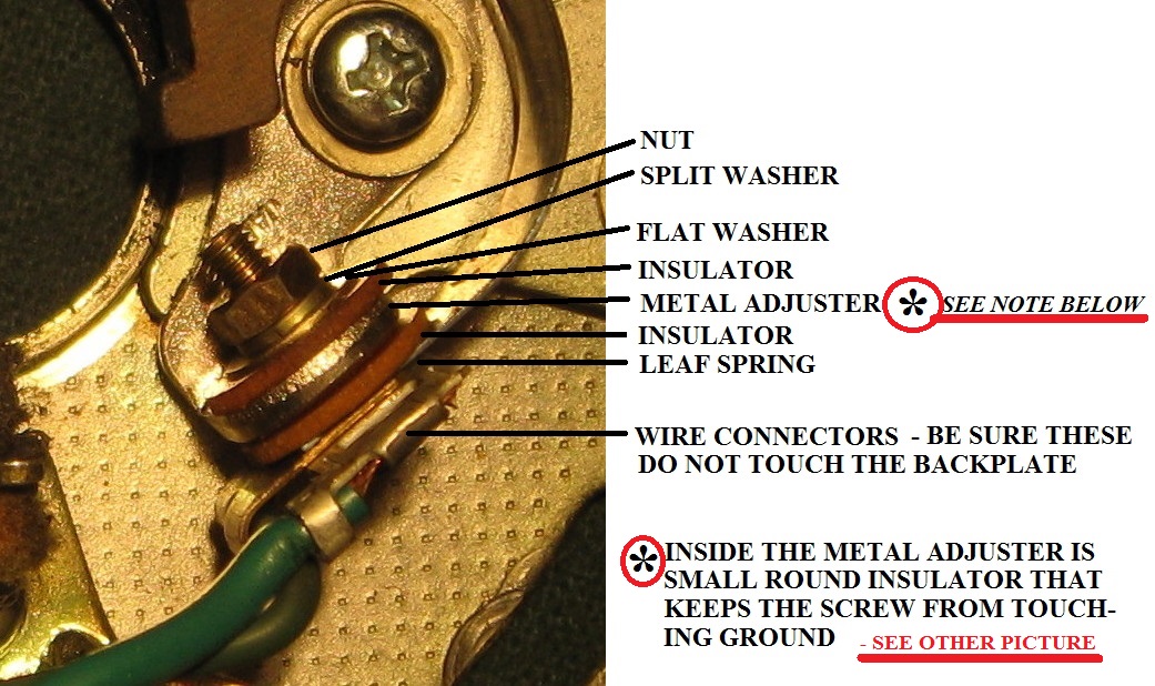

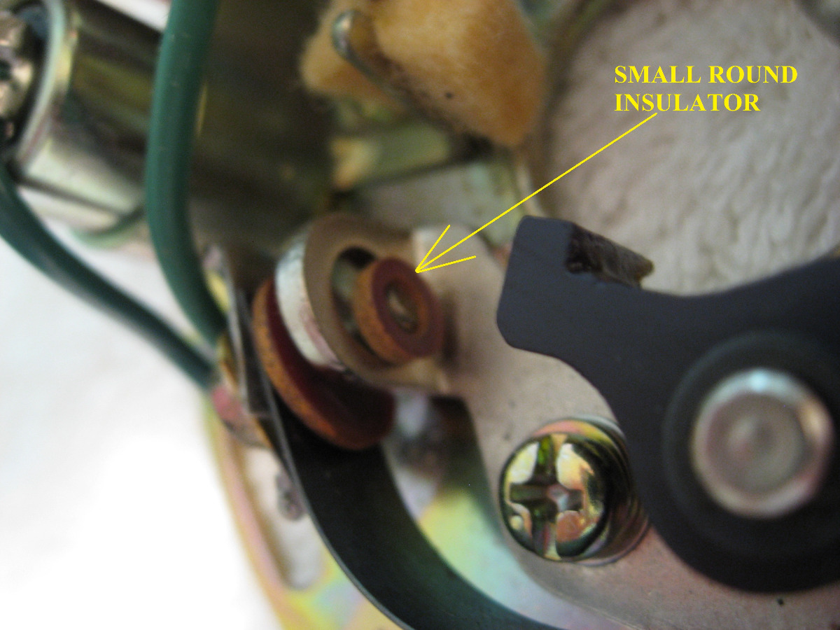

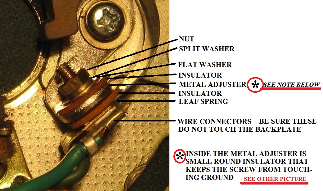

Here's how the KZ650 points insulators are arranged. Ed

Thank you very much. I am getting ready to leave for work, I will check either tonight when I get home or tomorrow morning. My new points came in as well. I really appreciate this post. Thank you again 650ed

Glad I could help. Ed
