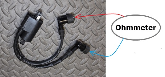

Hi Guy's trying to get an old KZ400 to run before a strip down and restore and I have no spark
Firstly the coil seemed faulty as when I did an Ohms test between both plug leads I got no reading, Purchased a replacement coil and installed but still same problem, new coil tests fine on both circuits with multimeter. So far I have checked the below
1. 12v Power to Red Yellow wire going to coil checked OK
2. Points, cleaned set and tested OK, "Points haven't been replaced by me but they look in good condition" and test fine with test light
Is it possible a faulty condenser can cause no spark? that's about all I am left with, I have ordered one but as I understood a condenser is just basically a capacitor to absorb high voltage so your points don't burn out too quick can this cause no spark if faulty?
Cheers in advance
Cheers in advance

Just learnt how to test plug caps, pretty sure this is my issue.....
Will report back
Will report back

Alright so it's my resistor caps, guessing the high resistance burnt out the original coil too.
Anyone got an NGK Replacement Part Number or equivalent I can use and is the spec 5k ohms?

Had some spare caps off an old CB400T, as soon as I put them on I got spark, tried the old cap again zero spark :blink:
Anyways have ordered some NGK LB05F to use eventually

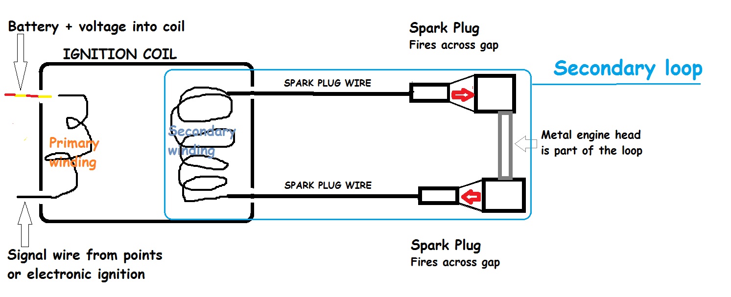

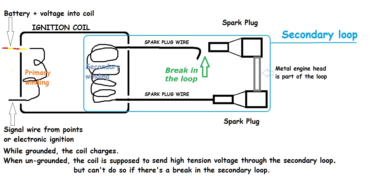

Defective plug wire?
Ohm-checked secondary loop (cap to cap)?
A non-conductive (defective) plug cap is one of the many possibilities whereby a break is created in the secondary loop which prevents plug spark.
Properly functioning secondary loop with
both spark plugs simultaneously firing:
