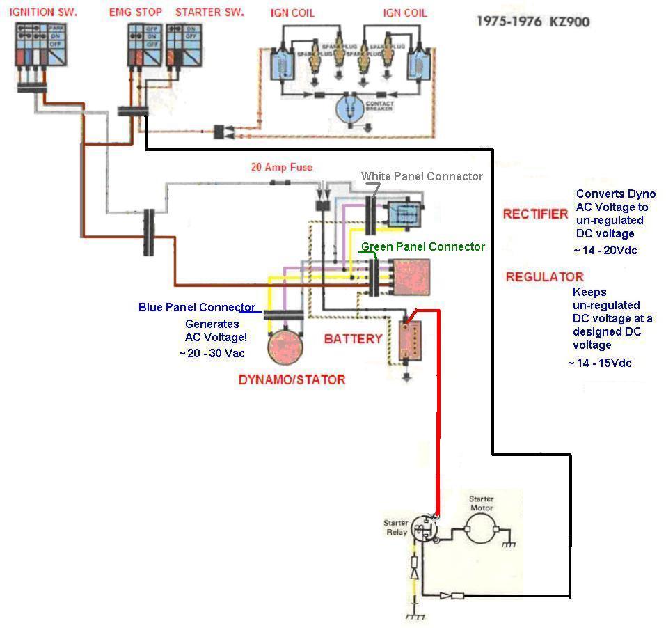

Basic KZ900 wiring may point you to the problem.....
Lights not coming on then verify fuse holder is not the problem, proper grounding to engine and frame and electrical Key switch....
