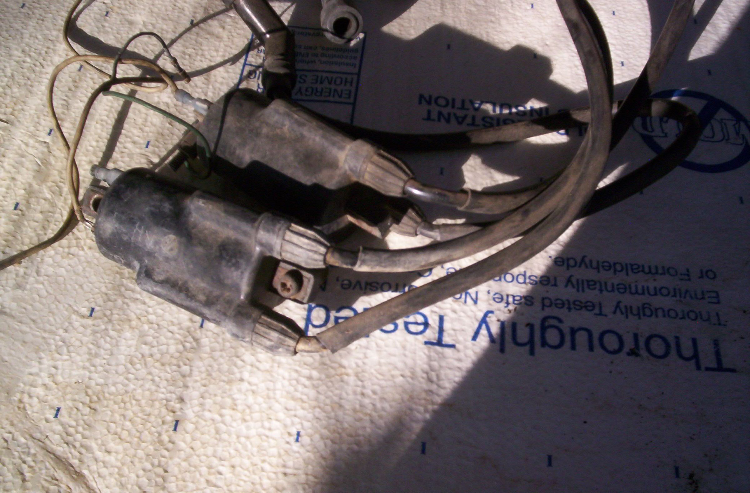

I bought some later model Kaw coils on eBay. Lots of them there. They worked fine but I wanted some Dyna green coils so I finally got them. Not a great big difference but I can find new replacements easy.
If you chose to replace the wires on your old coils you can use epoxy, JB Weld or silicon to glue them back in. Just be careful not to get any on the end of the wires. Rather than spend the money on coils, I'd buy the wires, try using my old coils and if that didn't work, I'd still have the wires for my new coils.
  • adbz650
  • adbz650's Avatar Topic Author
  • Posts: 11
  • Thanks: 0
Re: kz650 B melting coils
14 Nov 2016 10:17
#747949
Thanks Swest
The ones in the pic are identical to the old melted ones .... they give about 2.3 ohms of resistance. Ive managed to pick up a set of z1000 which had a reading of 3.6 ohms. Managed to get them fitted yesterday, tidyed up wiring and she roared into life on the first push of the button. Much better starting than before, only problem coils felt hot. Did nt run her for long but hoping to have a bit of a test drive tomorrow ... curiously the engine seemed to run hotter ??
If these fail I still have the new old coils of a B model .. giving 4.9 ohns but will take a bit of modifying to get them to fit. Also picked up some inline ht connectors so have a plan B. Is there anything else I should look at as to why the coils may be getting too much power ... its recording 12 volts at the terminal ?
Many Thanks
