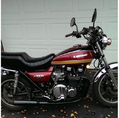

Thanks for the heads up. My "G" now has 34mm mukuni's and no longer has fuel injection, So I guess its essentialy a LTD now. So I suppose the proper LTD diagram would serve the same purpose.

Thanks . Z1 tank from a 75, holds more gas. Pod filters, 4-1 exhaust, re-jetted carbs. Sorry for the bad picture, its the only one I have I can upload right now.

Here's a magnification for squinters like me. :lol:
