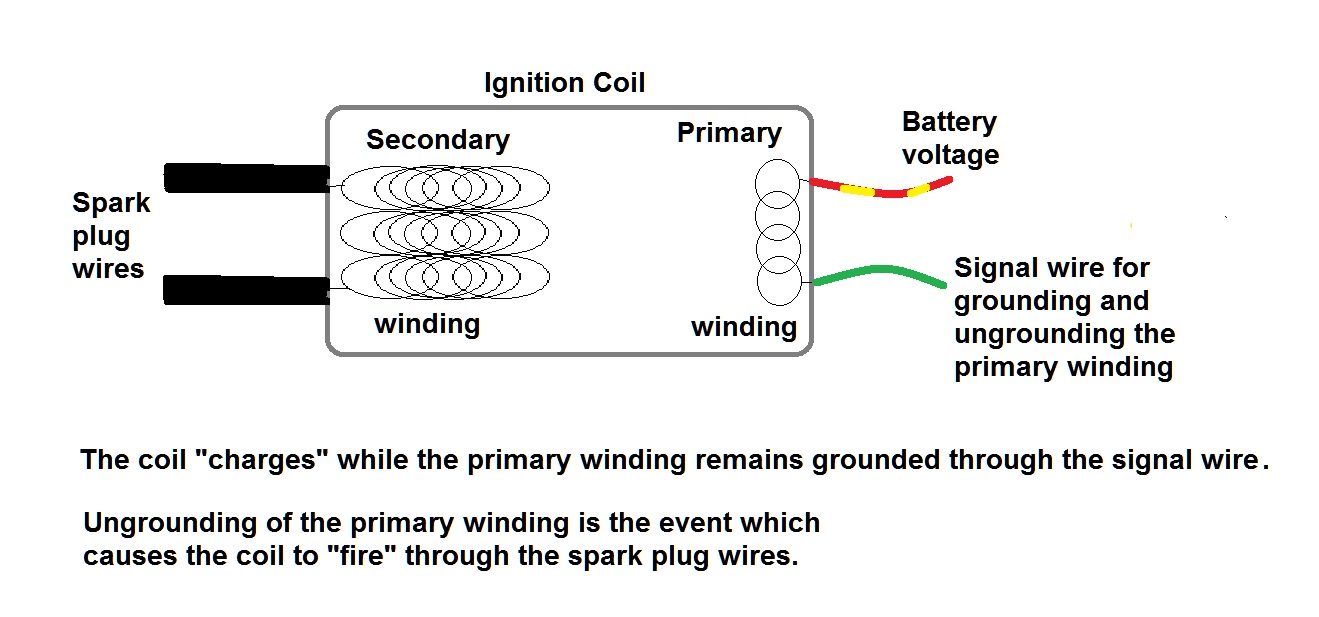

Ideal way is with an Electrotester which measures strength of spark. Kawasaki dealer service department may have this tool available.

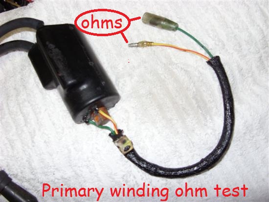

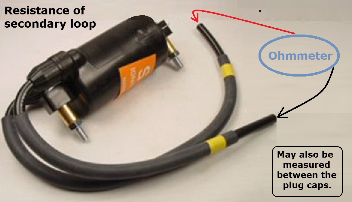

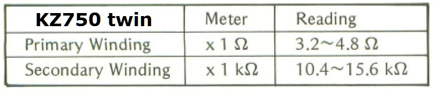

The typical owner test is an ohm check between the coil's primary terminals (where the small wires attach -- for resistance in the coil's primary winding) and between ends of the spark plug caps (the so-called "secondary loop" for resistance in the coil's secondary winding).
The simple ohm tests can likely show a direct short in the windings inside the coil, but usually won't show a short under load (as will the Electrotester).

Thanks again Patton,So between the blue and yellow for Primary,and between blue or yellow to spark plug end?

If your still listening,, I checked the coil out and got 4.1 on the primary and21.69 on the secondary with the plug caps still on.I seen this cat on youtube heat it up with a hair dryer while testing to see if it changes when it gets hot and did so and all stayed the same.What i'm experiencing is the bike cranks good ,a little time to warm up which changes the idle to faster as it warms up.Runs pretty good if you take it easy ,can hear some stuttering from both cylyders and if I hold it at about 35 to4000 rpms it will stumble un less I get in it or let off a little .I'm going to repack the baffles next to try to get it as close as it was when it was running good 6 tears ago.If you followed My other posts you know I haven't adjusted valves yet'The carbs have been over and over several times and has stock , I .think jets,125 main, 45 pilot.stock air box,and no leaks on either side of the carbs.I am going to try the valves,just covering all I can before taking any covers off.Great weather around here right now.Thanks again.Oljo
