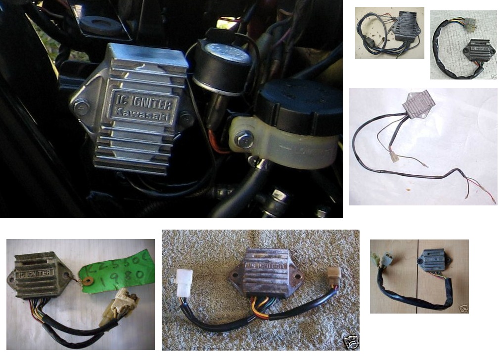

14 Sep 2016 06:32KZP1000 wrote: Is the dyna system easy to install? I know NOTHING about electronics on a bike
Very easy -- and you can do it. The "Igniter" (a separate component usually found under a side cover) is no longer used with Dyna-S.
Am uncertain of the exact igniter at hand, but here are several examples to which it's probably similar:

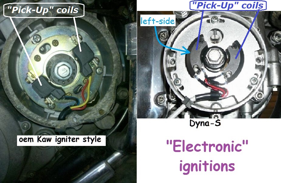

14 Sep 2016 07:05 - 14 Sep 2016 07:07The parts described as "Pick-Up Coils" are sometimes referred to as:
• Pick-Ups;
• Pick-Up Units;
• Pick-Up Sensors;
• Pick-Up Modules;
and perhaps other descriptive terminology I don't recall off-hand.
