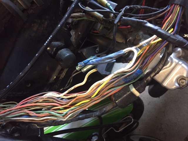

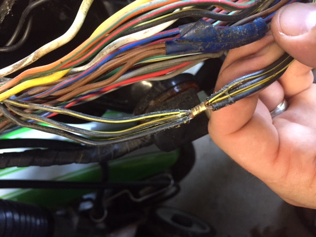

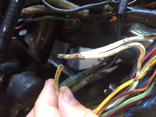

- pinball.ken
- Posts: 5
Re: KZ750-4 bad igniter?
03 Aug 2016 11:28 - 03 Aug 2016 11:54Attachment wiring-pic.jpg not found
here is the pic of the damaged wires. they were very hard to find inside the vinyl casing in front of the tank running into the headlight.
24 Aug 2016 15:52
thanks pinball.ken here I was assuming there was a faulty part that was causing my problems. I should have known better and checked the wiring. My friend always jokes when I find something fucked up- I bought this bike off of an "airplane mechanic". anyways I was trying to troubleshoot the coils and I had the key switched on. I leaned my hand against the main wiring harness and the lights turned off. I noticed this and tapped it and they turned on then off. I realized the vinyl was gone and it was electrical tape covering the wiring harness. After some inspection I found a broken wire.
24 Aug 2016 19:20
are these crimps stock? I can't imagine that they are. wrapped with blue electrical tape to identify them as crimped wires. then wrapped with black electrical tape over the whole bundle to protect them....
