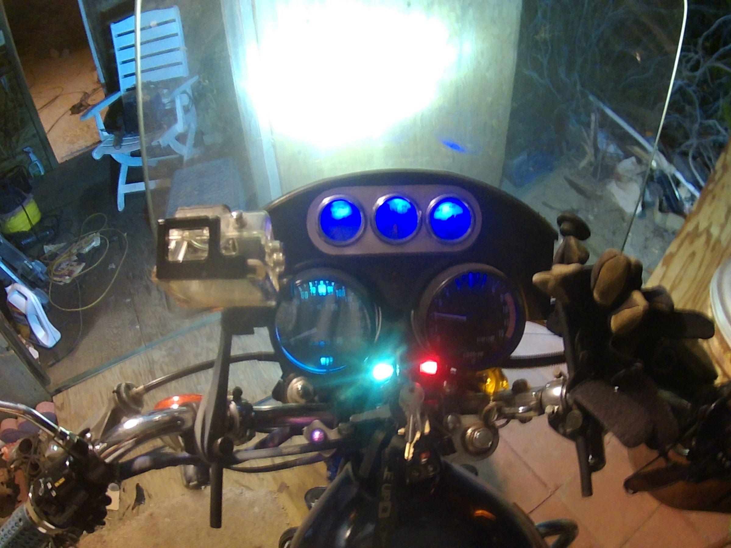

I replaced mine with LED's.
Attachment 19700101_000000_02-2-3.MOV not found
Last edit: 05 Jul 2016 18:02 by SWest. Reason: pic

Being the gauge light are so hard to get to, I did LED's. I hated them go out in a short time.

Some LED's are and some aren't. I'm going through that now. Be sure to get the super bright ones. The bulbs on the aftermarket gauges have the ends blacked out so there won't be a bright spot at the top and bottom. Still playing with mine now. :dry:

08 Jul 2016 00:18Me too and I paid the money for the premium ones (supebrightleds.com).swest wrote: Being the gauge light are so hard to get to, I did LED's.
