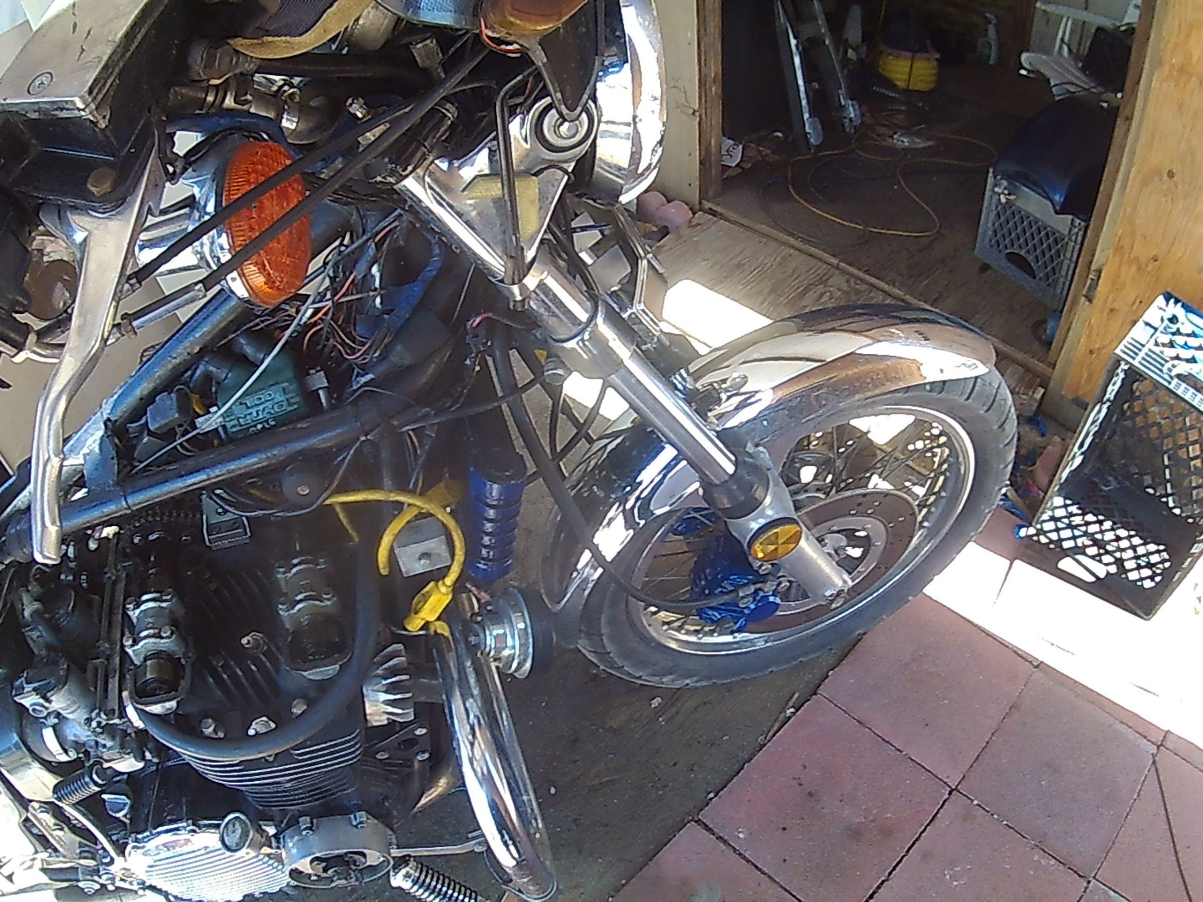

Even though my 77' KZ1000A that I'm now riding is running fairly decent for what it is, I was considering on replacing the stock coils and spark plug wires. Measured Both primary and secondary winding resistance's of the coils and got around 4.3 ohms and 24.5 Kohms respectively.
So they appear to be okay ? Only thing that I originally saw when I purchased this bike is that a couple of spark plug wires ( 3 & 4 ) were burnt on the outside of the rubber covering of the wires and the # 4 spark plug cap was broken ( cap replaced ).
So my question is, how does the Emgo 4 ohm replacement coils work that some venders are selling ? I'm still using the stock points. I wouldn't mind using other coils that would allow you to use different "colored" spark plug wires ( for that custom look ) then the ones that come with the Emgo coils and are permanent with these coils. Are there other coils that would work ?
Also, I'm considering converting over to the Dyna set-up but probably wouldn't be a good idea since I'm still using points ? Still trying to work all the bugs out of this bike.
