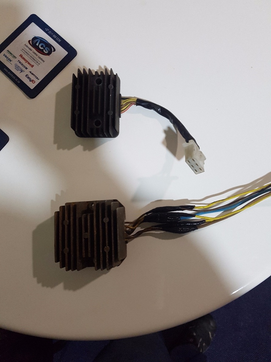

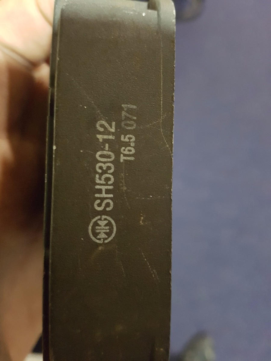

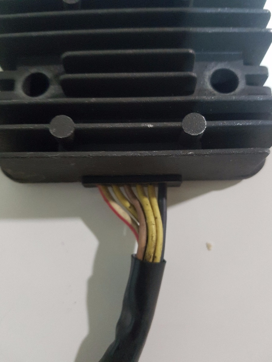

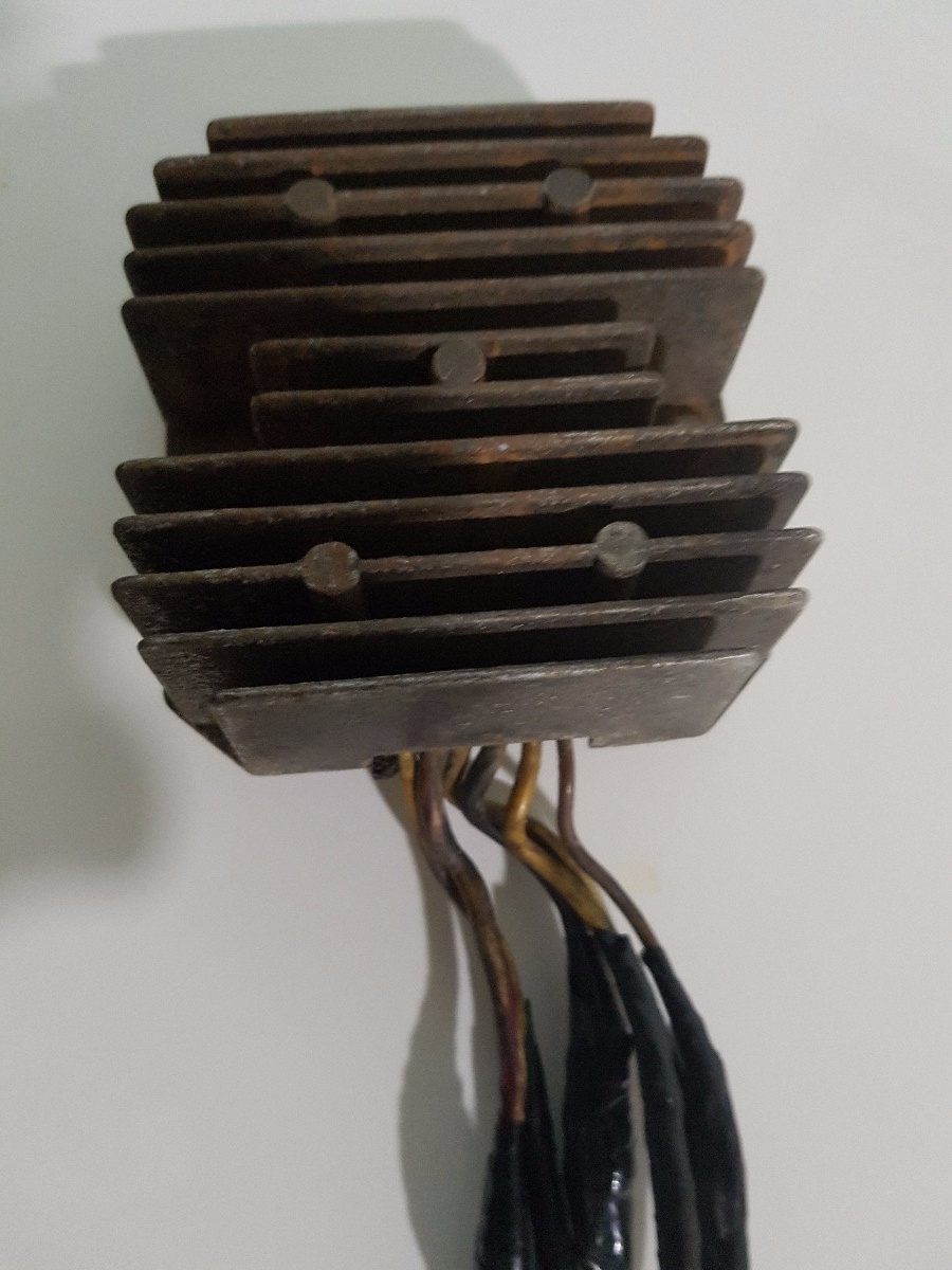

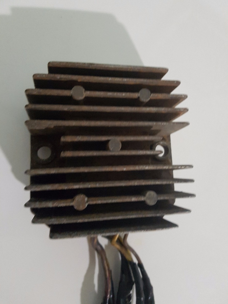

Good morning
I finally got a power rectifier can someone tell me how to wire it in the new one is a bit different from the old one

In the last pic which one are you going to install? the smaller one? is the connector the same or is it reversed?
From the 750-E2 wiring diagram. this is fairly typical.
3 yellow wires = stator wires. black wire = ground. red/white = power wire. brown = voltage sensor.
yellow to yellow (any order). black to black/yellow. red/white to red/white. brown to brown.
