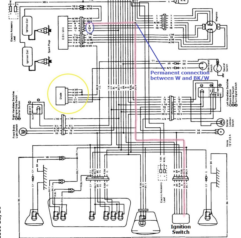

Several years back i wrecked this bike when some lady pulled out in front of me. I love the damn thing but have become so stuck i have contemplated giving it a viking funeral. After running through every little switch, checking every wire, and working on and off on this issue for the last year i have yet to find why i can not get the thing to spark. I just need a little guidance as i am not very good with electronic ignition. i know the coils work just fine but can't get a voltage to them. When tracing back it turns out i have zero volts at my CDI. I can't seem to locate on the wiring diagram where the CDI should be getting 12V from. I have found that all the wires going into the CDI from the harness circled in blue are grounded leaving only the wires going to the pickup coils, ignition coils, and diode left ( circled in yellow) . My assumption is that it must need to get 12V from the diode or it is shorting across one of the other wires circled in blue before reaching the CDI. Does anyone know which wire is used to expose the CDI to the 12V source on this diagram? i am assuming it exposes the ignition coils to a 12v source constantly and disconnects it to cause the spark correct? i also have 0V going to the diode but if that is what is supposed to supply voltage to the CDI i will at least have narrowed down the problem within the circuit.

I'll start by sayingI dont know anything about the 305 and I'm not great with electrics but I have had to patiently follw a circuit diagram to sort out issues on my 750.
So here goes in an attempt to answer the question " Does anyone know which wire is used to expose the CDI to the 12V source on this diagram?"
From the table labelled IGNITION SWITCH CONNECTIONS it appears that with the ignition in the ON position W (white) from the battery via the 20 amp fuse is connected to BR.
Following BR to the side stand switch and from there as G/W to the Diode I would think you should find 12V at G/W at the Diode if the side stand switch is operational and no breaks in the wire .
From the Diode to the CDI / Ignitor Im' thinking BR/W but this is just a guess.
That is a headache inducing wiring diagram.
Hope that helps

15 May 2016 19:25 - 15 May 2016 19:28punisher11b wrote: . . . coils work just fine but can't get a voltage to them. When tracing back it turns out i have zero volts at my CDI. I can't seem to locate on the wiring diagram where the CDI should be getting 12V from. I have found that all the wires going into the CDI from the harness circled in blue are grounded leaving only the wires going to the pickup coils, ignition coils, and diode left ( circled in yellow) . My assumption is that it must need to get 12V from the diode or it is shorting across one of the other wires circled in blue before reaching the CDI. Does anyone know which wire is used to expose the CDI to the 12V source on this diagram? i am assuming it exposes the ignition coils to a 12v source constantly and disconnects it to cause the spark correct? . . . .
Am not at all positive, but seems to me that W (among those circled in blue) from CDI is NOT grounded, but actually connects to BK/W from the ign switch.
And that Batt+ travels via BK/W from ign switch to W into CDI, and from CDI via R/BK and BK/W to ign coils.

15 May 2016 19:35That did seem troubling as they are currently shorted to ground....the plot thickens. :silly:Patton wrote: Am not at all positive, but seems to me that W (among those circled in blue) from CDI is NOT grounded, but actually connects to BK/W from the ign switch.

Would assure Batt+ is getting through the connector from the ign switch and through the connector into the CDI.
I think the black dot represents a permanent connection between the W into CDI and BK/W from the ignition switch.
If the CDI is defective, could consider posting a KZr Wanted in Classifieds, and might conceivably be interested in one of these crap shoot possibilities ?

i did try replacing the CDI with a supposed working one.... crap shoot as you said though. im starting to think that there is something in the wiring between the two. with the CDI disconnected those pins are still tied to ground. when testing the ignition switch per the FSM it did check out, im starting to think a second look may be required though.
